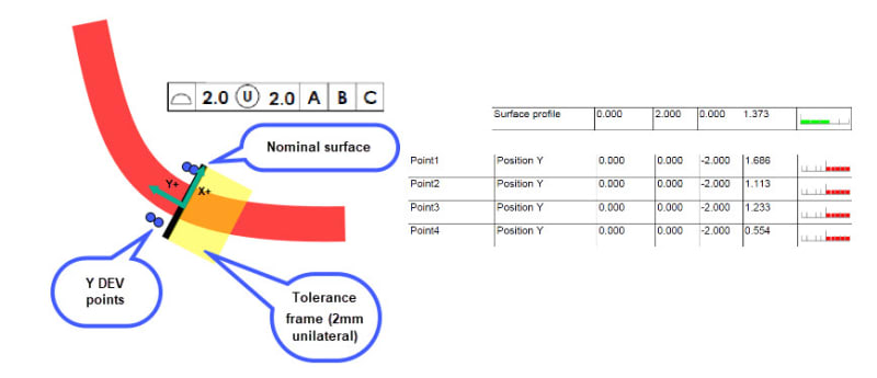

Apologies Pmarc, i didnt explain properly on the Y dev points.. Yes, i am shifting the Co-ord to the planes origin and then rotating meaning Y DEV's are each points offset from the face
J-Hendry,
No need to apologize.
Are you able to prepare a rough sketch showing the nominal surface, the tolerance zone disposition relative to the nominal and the measured points with Y devs?
Thank you.
I think this covers everything I'm seeing my side.(Symbol is current being updated from design team - This should read as UZ) If you need any more info let me know.
I am not sure I fully understand what I see but I am pretty confident that the tolerance zone in yellow does not represent the |2 UZ 2| requirement in ISO. Otherwise, it should be offset further by 1 in the minus Y direction.
The tolerance zone matches with how ASME defines it.
Assuming the numbers in the second column from the right represent Y deviations, then for the set of 4 numbers shown, the actual profile value should be:
2(tol value) + 2x1.686(max dev) = 5.372 per ASME
[2(number after UZ) + 1.686(max dev)]×2 = 7.372 per ISO

Should I understand that in ISO GPS a specification such as
|profile|2 UZ 0|A|B|C| does not make any sense?
Or better to say to is equilavent with |profile|2|A|B|C|?
greenimi,
Yes, specifying UZ 0 after the tolerance value does not add a value because the number after UZ defines the offset of the tolerance zone center from the theoretically exact feature.

If that's the case then I think for the sketch provided by J-Hendry I need some explanation, as it is not very clear to me your numbers.
ASME Profile |2 U 2|A|B|C| is translated into ISO as profile |2 UZ +1|A|B|C| doesn't it?
Now, per the ISO GPS provided skecch profile |2 UZ 2|A|B|C| which can be translated into ASME as Profile |2 U 3|A|B|C|
then the closes boundary is 3-1.686 = 1.314
So your numbers become:
2(tol value) + 2x1.314(max dev) = 4.628 per ASME
[2(number after UZ) + 1.314(max dev)]×2 = 6.628 per ISO
Why "my numbers" are not correct ?
greenimi,
Sorry, but I don't understand where the |2 U 3|A|B|C| comes from.
I am trying to translate from ISO to ASME, beauce in ASME we "know" how the reporting should look like.
So per J-Hendry latest email about his "engineers" agreeing to add UZ (instead of U) in the profile callout, then the callout become ISO
Therefore, profile |2 UZ 2|A|B|C| I was "trying" to translate in ASME
By the way what is the correct translation of profile |2 UZ 2|A|B|C| to ASME ?
Is not |2 U 3|A|B|C|?
If not, then which is?
