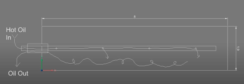

I'm working on a large machine that has an oil heated drum that runs partially submerged in tar.
This is essentially what it looks like and how it's currently built.
Dimensions are not exact and are in feet. (About 8 feet long)
As depicted they pump 250F° oil into the center pipe.
The pipe has a few hole pairs drilled 180° apart on the center in-feed pipe.
The oil leaves the drum out the end as shown.
Looking at this I think it really can't work very well because of the lack of pressure control on the oil, poor flow rate control, and probably lousy flow sharing by all the holes.
They've dissembled the drum looking for clogs or gunk and there has not been any.
They are complaining that the surface temperature of the tar soaked surface is all over the place varying by more than 70F° in various poorly defined regions. This is causing the laminating process to be.... sub par..
Is there a more modern standard way to be doing this that provides a modicum of uniformity? Maybe a single eductor at the end of the in-feed pipe? Or ?

Yes as the temp sets the thickness of the tar. Hence different thicknesses all over a single laminate web due to the temp variations.
How big are the holes?
About a quarter inch.
Is there any data on how much of the feed oil is exiting any of the holes?
None what-so-ever. I don't see any reasonable way to ever get that either since this whole mess is rotating.
Is the filling of the drum with oil for thermal mass/stability?
Not sure what they were considering in the 1050's when someone built this thing.

OK, so two likely solutions are:
> incorporating some sort of agitation to increase the consistency of the temperature
> forego the oil fill and have some sort of two-layer counterflow spiral along the circumference

Does the oil recirculate? If so, maybe eliminate the holes to force all the oil to the far end and increase the flow so the delta T is small, thereby insuring temperature gradient is the same as delta T. That's essentially what we used to do with water cooled molds. Trying to balance flow with different sized holes and channels was a nightmare.

Getting both flow and mixing is a trick. The holes should be small enough that you will get similar flow out of each. And remember to use the hot viscosity of the oil. If possible having short lines to deliver the hot oil to near the inside surface of the drum to help.

With enough pressure in the header you should be getting fairly equal flow, but I'm concerned that there isn't one at then end to spray oil at the end plate. This end could get colder
Internal blades to mix it all about would help - either as angled blades or even bars like a washing machine
I would be tempted to block off that first set of holes closest to the exit - too much short circuiting there.
The oil will surely be at a level above the exit hole - your waves look very unlikely unless you've got some big blades in there.
Line the ID of the the outer tube with a tube of aluminum to get some axial flow from hot to cold spots.
Some good ideas here. The industry standard is hot oil so steam ain't happening. If you look at temperature controlled cylinders the offerings are; hot water, cold water, 'thermal oil'. Steam is an entirely different animal requiring people who understand it.
Various interesting suggestions can not occur because these cylinders tend to be pipe with ends welded in. There is not access except thru the removable inlet/outlet pipe. Adding various directing pipes, mixing paddles, additional walls, and structures can't be done.
Trying to gauge the hole placements and sizes and modifying them, while certainly possible would probably take 6 months of continuous modifications and would only EVER work if the oil temp/pressure/flow was rigidly controlled and fixed. Probably impossible in a facility plumbed with heat-traced oil lines running everywhere servicing multiple machines and processes scattered about the place.

If all you have access to is that internal pipe then try some modifications.
I would have a few more but much smaller holes pointing vertically up to spread the initial heat into the roller.
What happens after that is just a bonus as it flows out.
Keep the total square area of the holes less than about 1/3 of the inner pipe area and you will get equal flow so long as you have enough pressure to fill the pipe.

After turning this over and over it occurs to me the following things:
The introduction of fluid is in the radial center of the cylinder
This fluid is the hottest and therefore the lowest density and viscosity
The cylinder is likely rotating at a high rpm (50 to 100 rpm, maybe higher)
The exhaust is from near the radial center
The fluid is lower conductivity than the metal
In operation, the general motivator is to retain cooled higher density and viscosity oil against the surface of the drum by angular velocity and the related radial acceleration and maintaining a low viscosity, low density layer along the inlet tube creating a short circuit for the hot oil to immediately flow out.
The location of the holes is not important as the Coriolis acceleration will prevent direct impingement and buoyancy will resist outward motion.
It should be a double wall cylinder with a small gap between inner and outer shells and the oil supply and oil drain separated with the oil introduction confined in the gap; it might be better for the oil to be introduced at the axial midpoint and exhausted from the ends.
This would retain the hottest oil against the outer shell where it can carry heat to the tar, be prevented from being removed by buoyancy before that job is done, and prevented from forming an adverse thermal or density gradient.
