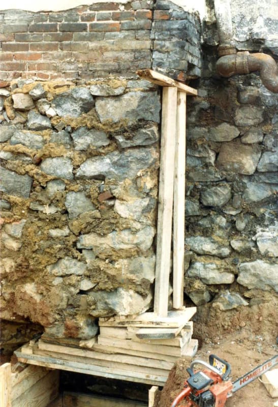

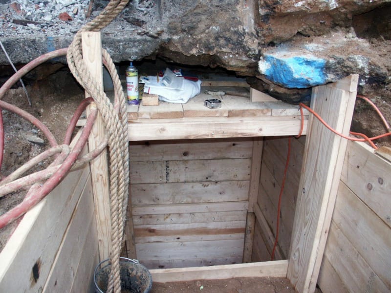

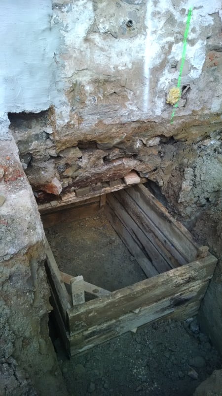

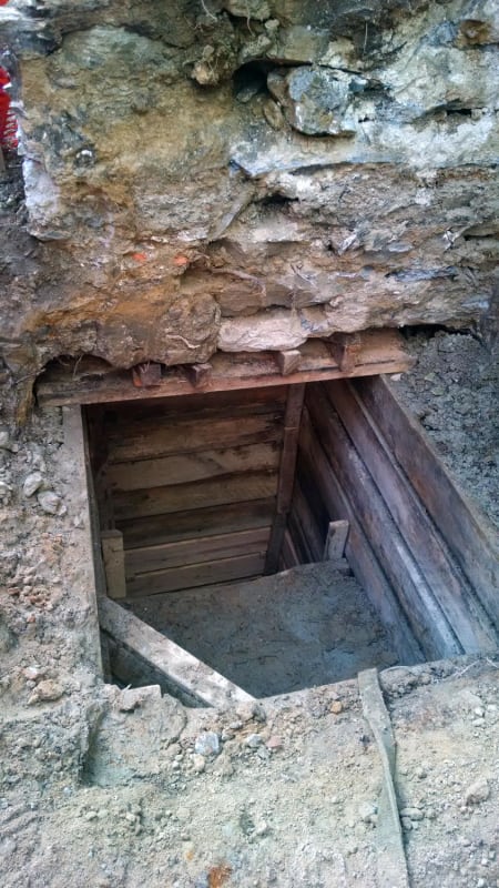

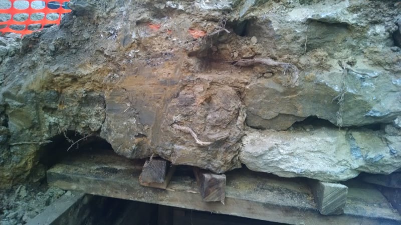

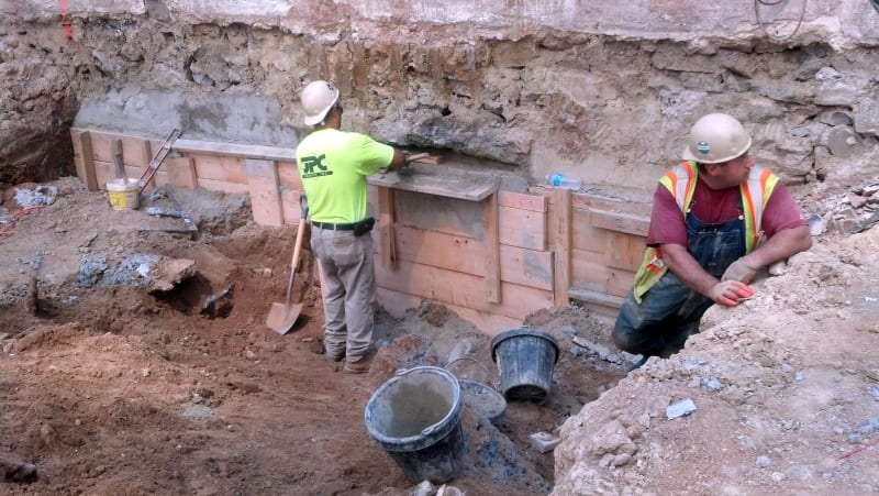

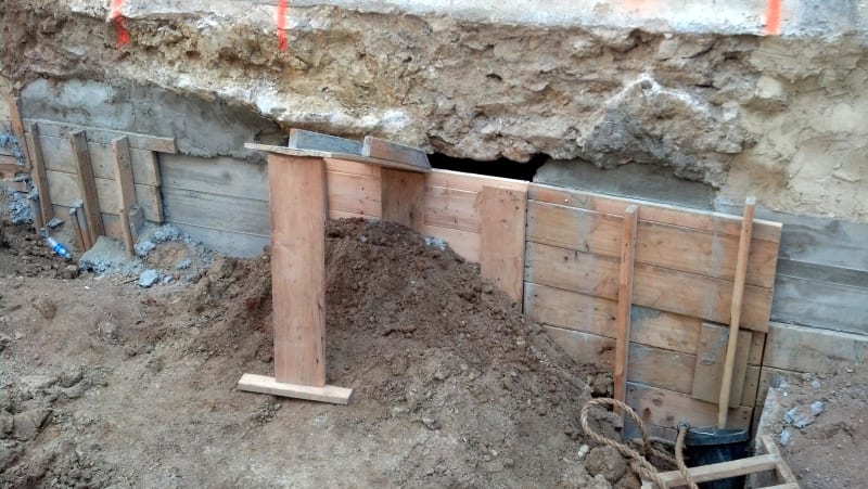

Here are some photos for some rubble stone walls.
Try sticking a steel plate under this rubble stone foundation wall.
Note how the bottom of the rubble stone wall can vary. Where will you place the plate?
