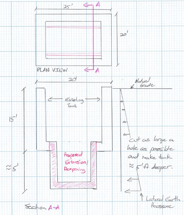

Can underground conventionally reinforced concrete rectangular tanks be 'deepened'.
The wastewater department has asked me if this is possible? I told them that I do not think it is. (or not without being crazy expensive.)
That was not the answer they were looking for.
I don't see how you connect the new section and get reinforcement developed, etc..
What do you think? See attached.
Thank you!
Anything is possible if you throw enough money at it.
[li]Consider that the bottom slab of this structure supports the walls. If you cut it away, you have short term and long term effects. Short term regarding the loads on the walls during construction. Long term has to consider the loads from both the soil and liquid inside.[/li]
[li]Excavating inside the structure is tricky.[/li]
[li]How do you form the lower walls? Are you expecting the soil to stand up straight like that?[/li]
I've been asked to do this several times. But it never materialized. It didn't price out for me and I don't think it will price out for you.
If the walls are monolithic with the bottom slab as you show then I suspect those walls partially rely on the slab for some flexural resistance. Do you have any details of the reinforcement in the tank?

If you have the old drawing, you can recalculate it. The good thing is, the tank is pretty square. So your geometry helps. I would analyze the wall as if the load only goes horizontal wall. See if the existing rebar can take the positive and negative moment.
If that does not work, you can probably install buttress/counterfort in the middle of the wall. This will break the spans in half. More than likely the existing rebar will work after you do this.

If the existing walls were designed to span horizontally between the 4 corners, then you don't need the base slab and it can be removed so you can dig the additional 5 feet. However, you would probably still need to vertically support these walls so that they didn't drop when you dig 5' deeper. The walls could be supported by a few different methods - such as helical piers inside the tank at the base of the walls, driven or drilled piles outside and along the tank walls, underpinning, or by hanging them from beams and cribbing.
If the existing, 4 walls were designed to get their support (cantilever up) from the existing base slab, then you have a bigger problem and the walls would need to be supported vertically, as described above, and would need to be internally braced, probably at two levels, across to the opposite walls.
If the soil below the tank is not very stable or if below the ground water level, then you have more problems - dewatering and shoring of the additional 5' cut.

What if you drove sheet pilling around the existing tank? Then, cut some of the bottom out, but save the rebar by just bending it out of the way of the work below, cross brace the tank as needed and excavated under the tank. Removing some of the fill btwn. the tank and the sheet pilling should allow the tank to settle. They often build large caisson in a similar way. Then build the new 5-6’ wall on top of the existing walls, in the dry, and recast the floor hole. Maybe you still need some new cross walls, with water movement holes, to stiffen the lower walls and bottom for the increased soil pressures.
Assuming there are existing sewer lines tied into this structure, you will want to limit any movement or settlement to whatever the tie-in connections can tolerate.
Get a good geotech involved to cover the soil stability aspects for you.

Place a cofferdam frame with some small corner braces in the bottom of the existing tank to act as a base slab for support. Cut holes in the existing slab to drive soldier piles. Cut remaining portion of slab to excavate for proposed deepening. Cut the top of the soldier piles immediately below the existing slab. Cast propsosed deepening walls directly against the soldier piles and tie it into the existing slab. Abandon soldier piles.
