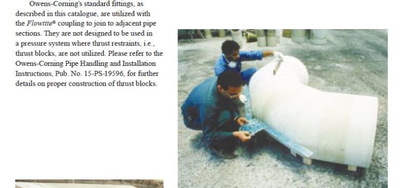

This is the copy and paste from FLOWTITE catalog..
(Owens-Corning’s standard fittings, as described in this catalogue, are utilized with the Flowtite® coupling to join to adjacent pipe sections. They are not designed to be used in a pressure system where thrust restraints, i.e., thrust blocks, are not utilized. Please refer to the Owens-Corning Pipe Handling and Installation Instructions, Pub. No. 15-PS-19596, for further details on proper construction of thrust blocks.)..
My experience is that, GRP pipe has certain disadvantages if ambient temperature and sustained pressure is high . The use of pull out resistant joints for pressures more than 5-6 bars is not reasonable..If the pressure is higher than 5 bars, the bends and tee branches should be fully embedded in thrust block to resist the developing bending and axial forces..

Ok. Flow tite is a form of push fit and so yes, in that application they would need anchors.

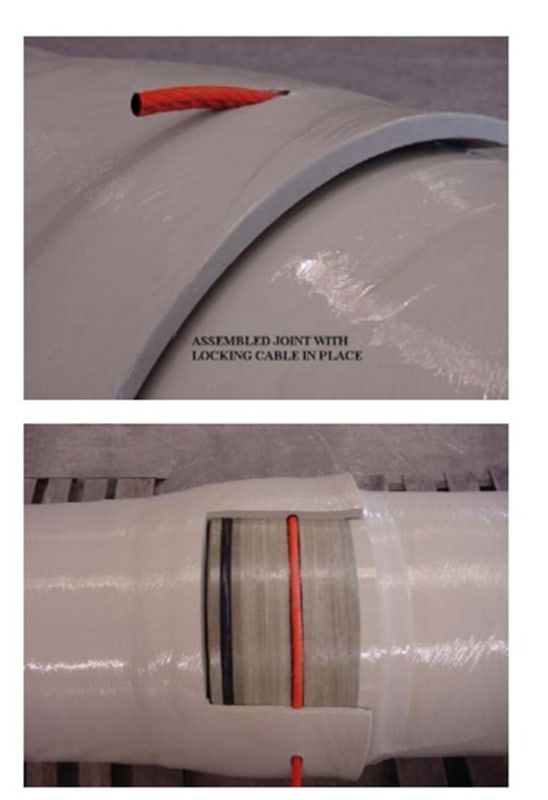

That cut away shows the key issue.
Your sealing is wholly dependent on about 3mm surface length of an elastomeric band (O ring).
12 bar design probably only had one o ring fitted,
After 20 years they tend to age, crack and don't seal as well.
I think you're looking at either accepting the leakage rate or total replacement of all O rings so a major excavation of the entire network.
Ask Ameron what they suggest...

You don't need a thrust block for either of the jointing systems you have. The O ring and pin lock pipe is locked together by the locking cable and the glued taper fit is strong enough not to need any anchors.
