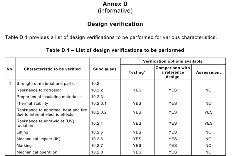

che12345 said:
4. In your case, the boards are 690V,75kA and 400/230V 20kA. It is likely that the boards are of different (design/arrangement) [in busbar size and distance between holders].
IEC 61439 - part-1 allows for design verification by three options,
1. Testing (By actual Testing) - may be on a representative sample.
2. Comparison with a reference design - Test already made on a similar equipment
3. Assessment - using calculations to verify
(Is this what you meant by thorough reassessment to verify)
Nick: per your request to che ... reassessment means just that - either comparison to known (and proven) design OR a specific type test on the board in question. For the resistance to environment issues (heat and ultraviolet) the vendor has the option of using calculation methods - if acceptable to both you and the authority performing the type test review, otherwise they're stuck with performing the "real" test.
