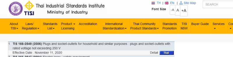

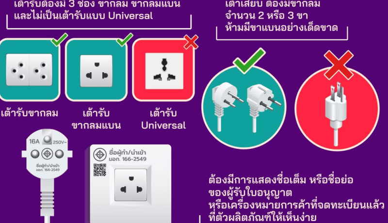

The Thai Industrial Standards Institute lists TIS 166-2549 as a compulsory standard for plugs and socket outlets for household and similar purposes. The link of all compulsory standards is available at It might be appropriate to check the standard to ensure that your product does not contravene Thai laws.

With a bit of help from Google Translate:
TIS 166-2006 said:
Scope
1. This standard covers plugs and socket-outlets, fixed or portable socket-outlets, for use in alternating current, having a rated voltage not exceeding 250 volts and a rated current not exceeding 16 A, intended for use in residential and similar general purposes, both indoors and outdoors, with an ambient temperature not exceeding 40 °C.
2. This standard also covers plugs and socket-outlets in socket-outlet sets and portable socket-outlets included in socket-outlet extension cords that are part of electrical appliances, unless otherwise specified in the standard for the relevant electrical appliance.
This standard does not cover:
- Plugs and socket-outlets and couplers for industrial use
- Appliance couplers
- Plugs and socket-outlets, fixed and portable socket-outlets for extra-low voltage (ELV)
- Socket-outlets incorporating automatic fuses, etc.
- Requirements for flush mounting boxes, but covers only the requirements for surface mounting boxes. (surface-type mounting box) which is necessary for testing with sockets.
For definitions and other details of the product, see
Is this residential or industrial use?
I own a number of adapters I use for overseas travel. None of them change voltage or frequency, they simply adapt the blades so they fit. The UL devices I'm adapting of course need to be rated to allow a range of voltages and frequency. It must be allowable under UL to put such a plug on a range taking device.
