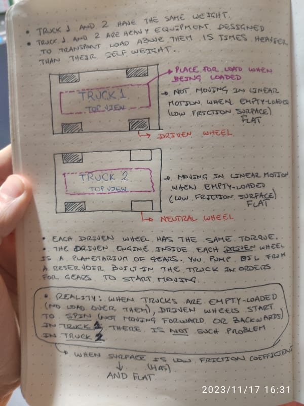

Hello folks,
So, just imagen you have two commercial trucks, one with 2-wheel-drive and another with 4-wheel-drive, and their WEIGTH is the same.
Great, they are being manufactured to be able to be driven on a flat surface, both of them.. Like driving on the road.
Now, this is the question... Imagine you start scrapping both trucks the same way, I mean, you start to take weight off the truck, like reducing their self-weight...
Can you find the situation that the 4-wheel-drive truck will NOT go forward due to lack of weight on each axle (and thus less friction), but to start SLIDING due to much torque?
The 2-wheel drive truck will be able to go forward since the two wheels need to overcome their own resistance, plus the resistance of the other two wheels?
Where I can read about this?
Have a nice weekend.
To make it easier... you turn off the driven engines of two wheels, and then the truck is able to move in linear motion (no spinning of the wheels). How?
The facts are clearly incomplete.
What were the trucks being used for when you observed this many times in several locations?
Ok. As I said previously, it is easier than that..
Just imagine that you have a truck with four driven wheels, and when you try to move it in linear motion, you cannot, the wheels just spin... then, you turn off the engines in two wheels, ending up in four wheels touching the ground, two with driven engine, and two in neutral (you turn off their driven engines), the truck start moving in linear motion.
How?

If you start reducing the same weight in each truck, will you reach the situation when the 4 wheel driven wheel will start sliding due to lack of friction force to start moving,

Q remaining 10: Show the hydraulic schematic of the two different trucks.
Q remaining 9: How many wheels spin when all are driven?
Q remaining 8: Was power to two wheels actually removed or is this a guess?
Q remaining 7: Was power to the slipping wheel(s) removed?
OP's problem seems to be that the wheel is sliding sideways. Torque will not correct this problem.
Not seeing sideways motion in the diagram. This leads me to believe the 4WD has all motors tied in parallel with no flow balancing, so if one spins there is insufficient backpressure to move the other motors. Whoever designed the 2WD did use a flow balancing circuit so it applies flow regardless of torque requirements. The advantage to not having flow balancing is to avoid Ackermann steering speed problems.
