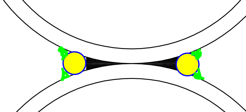

Dear all,
Greetings,
I have two pipes welded together as attached, they are a section of a cantilever. I can’t add one pipe only instead for architectural purpose. Is it accepted to consider them as one cross sections by getting the equivalent inertia for both pipes in resisting the major moment. Kindly advise.
Best regards,
Mohamed Maher

This is built-up section or compound section . However it is not efficient and the joint is at max. shear..You are expected to design the weld .
The weldment will be groove weld with lack of penetration. In order to calculate the thickness , assume root opening 4.0 mm and groove angle min. 15 degr. and calculate the necessary T.

I agree with HTURKAK regarding lack of penetration of the weld, essentially the weld in my eyes will be no better than a fillet weld and you never get full penetration on a fillet weld, see this link
Fillet welds fail in shear so you have to design the weld based on the throat area of the fillet, I personally think that you will have problems trying to weld two tubes in the manor shown and keeping them aligned.
I would not assume composite action due to my concerns with the welding and so I would assume that you have double the inertia of one pipe.

Your sketch shows two pipes approx. 141mm o.d. and about 6mm thick, nested one atop the other. Your welds would be something akin to flare vees or flare bevel welds. They are not a particularly good or easy to make weld, in a quality way, from a structural standpoint. You should avoid them in this application. I would use two 140 - 150mm wide by 8 or 10mm thk. bars, one each side, standing vertically. Grind or nibble a 20̊ bevel on the long, front corners/edges of these bars, with a 1 or 2mm land of sorts, on the back edge, maybe grind that a bit to conform to the pipe o.d. shape. Stand these bars vertically in your sketch, on either side of the nested pipes. The weld joints will then be at about 45̊ below/above the horiz. axes of the pipes, and you will have a nice groove weld to fill, a measurable weld throat. Draw this whole system out, to scale, to see how it works/looks. You may have to thicken the bars to get enough weld throat. You then calc. the shear flow (weld size) of these welds for your combined section. Check any punching loadings (radial loading), from the bars to the pipes, which might cause pipe buckling. The 140-150mm wide bars gets these joints high enough on the pipe shape so this shouldn’t be much of a problem.
I like dhengr's proposal and would have suggested the same thing if he hadn't.
Depending on what look the architect prefers, the detail shown below may be another viable alternative to improve the welding condition.
