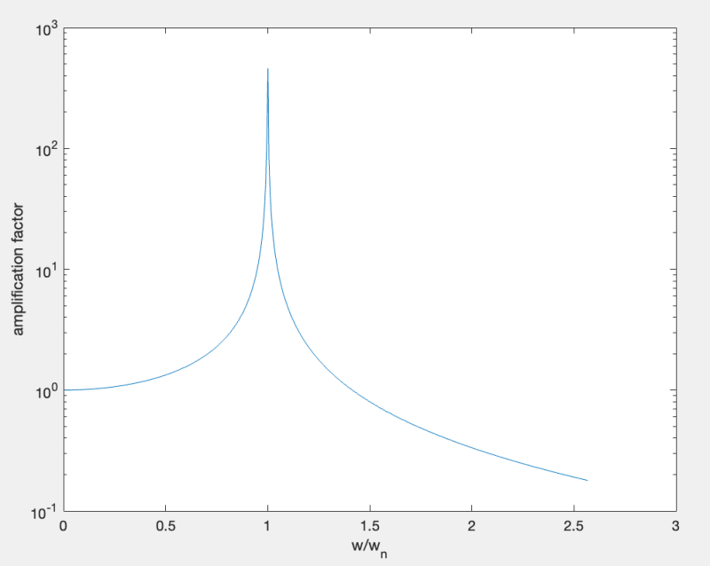

the main system is a cantilevered beam with a lumped mass at the end. The beam itself does not have mass. The lumped mass experiences a periodic force excitation. The system can be expressed like follows:
For the SDOF system, the amplification function looks like this:
This is why you are disagreeing with me by saying the frequency response should contain two peaks, right?

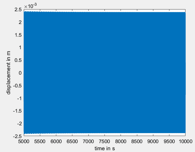

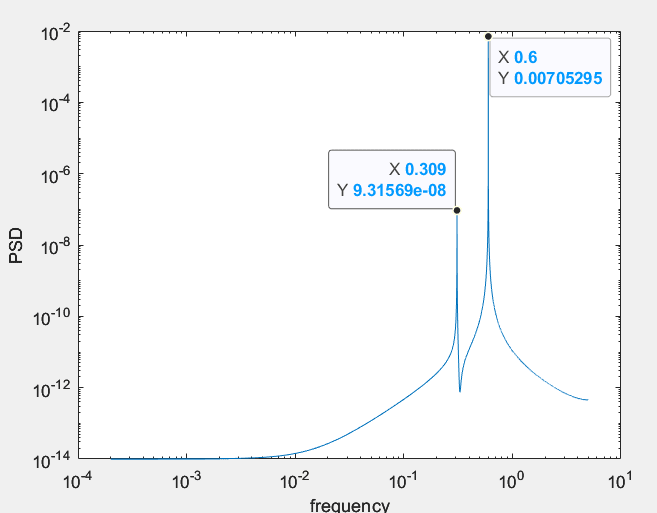

But I modeled this system in ANSYS APDL, just like in the first picture. Within transient analysis, I applied the time variant load of F(t) and by PSD analysis of the SDOF displacement I get the following graph:
The only explanation for this I can think of is that the structure is excited with the 0.6 Hz excitation, but the response of the structure at 0.6 Hz is very small, even though it makes up a big part in the vibration overall. Thats why there is a peak at the 0.6 Hz frequency. And since the response of the system is small, by expanding the SDOF system with another spring-mass system with a natural frequency of 0.6 Hz, the main system is now getting excited, more by the second system than by the external excitation itself. Does this make sense?
Best regards
The SDOF linear system can only respond, in the steady state, at the frequency that it is being driven at. Hence there is something fundamentally wrong with your psd plot. How exactly are you calculating the PSD?
You also seem to be using some very undamped material, I wonder how your time based analysis gets to a steady state from that? real structures, even monolithic blocks of steel, have damping of the order of 0.1 %
