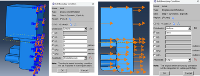

Hello, I am a first time abaqus user.
I have two identical parts assembled as shown.
I'm trying to simulate the friction as they are both removed.
These are what I've been using but I'm not sure if they are correct.
Step: dynamic explicit
Interaction: general contact + penalty friction coeff + normal behaviour (hard contact, allow separation)
Boundary conditions:
- 1 part fixed: 0 in all 6 dof
- other part: see image for 2 boundary conditions
My result doesn't seem to generate friction along the sliding surfaces. Would appreciate help. thanks.

You should avoid applying BCs to whole parts involved in contact. But did you check the CSHEAR results and did you try refining the mesh in the contact region ?

Sorry, I am rather new to ABAQUS.
When I try to change the BC of the moving part, I keep getting problems. If I only select the cube that is the non-contacting part, only that part moves while the non-selected parts doesn't.
I've changed the BC of non-moving part to only apply at the base surface, looks like there is more color now.
I checked CSHEARMAG results and looks mostly blue
My mesh is currently C3D10 elements, if I try to reduce the element size it looks like more warnings appear during mesh check.
I'm not sure but it seems like 'general contact' cannot generate shear stress at rigid surface?

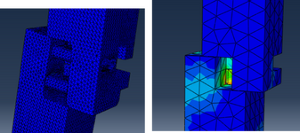

Ok, I misunderstood you earlier. I've added pressure load acting on the surface that is opposite direction of BC displacement.
I just randomly set pressure load as 10N.
I ran the job, is my results normal? I still don't see much colours being generated.

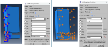

Since I removed all the BCs of the moving part, I have to use coupling and concentrated force to move the part.
I created another coupling that couples all nodes of the part to RP-2.
I created concentrated force at RP-2 (I guess this is what you mean by applying a force BC at the "top")
I can see stress forming at the non-moving part, but I feel that the stress is generated due to the concentrated force, instead of friction.

Some update:
I tried performing this using another simpler model.
It looks like I can do it with 2 interactions: general contact + surface to surface
Mesh element: C3D10M
However, when I tried using the same inputs with this model, I'm getting Distorted tetrahedral elements.
Correction: I was wrong, the mesh elements doesn't seem to matter.
I tried performing on my main model and simpler model using C3D4.
The simpler model on the right has more colors.
