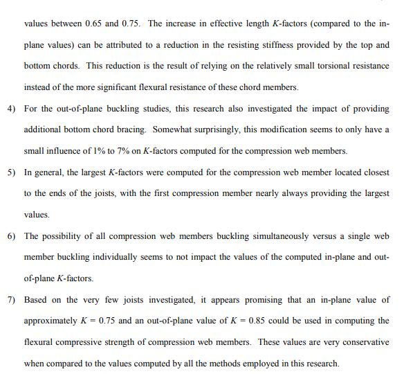

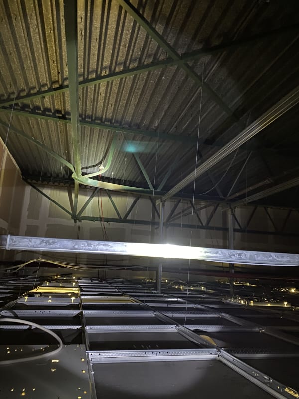

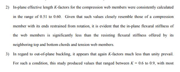

Someone please refresh my memory..
A standard steel warren truss supporting roof decking - I would typically take effective lengths of internal diagonals as 1.0L. Can this legitimately be taken as 0.7 or 0.85L?
(Trying to get an old truss to work on paper!)
