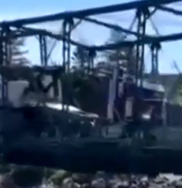

I don't think it was buckling that caused this, I think a tension member failed. The failure initiated on the far side truss - it looks to me like the tension member failed, then the top chord turned into a bending member, and it failed. See screenshot below.

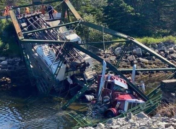

The picture below gives you a pretty good look at the equipment being moved. The driver is lucky to be alive.
saikee119, we posted at the exact same time. Mid-span wouldn't be worst case for shear. It looks like it failed in what would be (or close to) worst case shear - when the rear axles of the trailer start to load the bridge.
CANPRO - BOOM! was only my first suggestion. The second should have been "Twang!" but just said a tension member letting go would also not give much warning.
Good observation on shear; not sharing much load with the far end could overload it, but it looks like the part most exposed to shear is still attached to the supports.

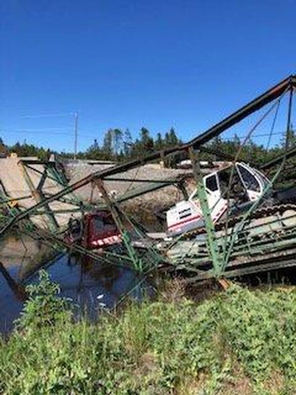

The way it's crumpled to the side suggests that one of the diagonals across the top let go first, letting the sides fold over.
They are attached on top of the truss and therefore difficult to inspect for corrosion; I suppose the investigation will explore these options based on a much better inspection of the wreckage.
For sure the last couple of web members were seeing higher axial loads, but they might have been in better condition. Also, the last diagonal is a compression member.
The diagonals across the top would provide lateral stability to the top chord and handle lateral loads, I can't seem them being highly loaded here or leading to sudden collapse. I think the top chords are bent so much laterally because the far side truss lost all capacity when the tension member failed and pulled the near side truss downwards and sideways.

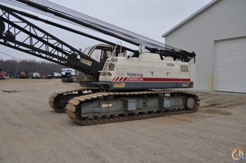

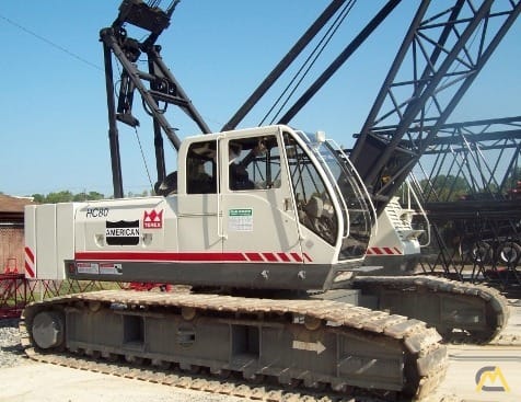

Hard to tell from the pictures, but that crane appears to be a Terex HC 80. 88,000 lb transport weight includes side frames and boom inner.

Perhaps the operator did check the Terex HC 80. 88,000 lb transport weight includes side frames and boom inner. He could have forgotten the transporting truck's own weight. 88,000 lb is about 39 tonnes and the bridge was certified to carry 41 tonnes.
Bit difficult to find the unladen weight of a tractor unit and low loader but seems to be somewhere in the region of 15 to 20 tonnes.
So total of maybe 60-65 tonnes.

This is true only for some components of the bridge. The web members at the end of the bridge would see their maximum demand when the load is applied near the end of the span. Similar to a simple span beam having its maximum shear when a point load is located near the supports. It looks to me like one of the web members broke just as the rear axle of the trailer hit the bridge.
