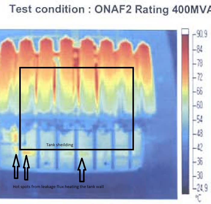

bacon4life - How this thermography was taken? From outside tank? The red patches are of shield? Then it looks bit strange for me. Usually the shields will be cooler than near by tank.Normally transformer designers follow two methods to mitigate the impact of leakage flux (extra load losses from eddy currents and hot spot temperatures in tank)- magnetic shielding where packets of silicon steel laminations fixed on tank(10-40 mm thick) covering the winding height + 1000 mm.The flux coming from top of winding enters the shield moves down and re-enter at bottom of winding. Since silicon steel provide a high permeability path with very low losses, leakage flux will not enter in to steel to create hot spots. Another way of creating magnetic path is providing shields (made of silicon steel laminations) at winding top to direct winding flux back in to core.
Second method is electro-magnetic shielding where conducting material(copper 5-6 mm thick) or aluminum ) is used to cover tank on areas where flux impinges. Flux will create an eddy current in copper sheet that will repel flux back in to the gap between tank and winding thereby shielding the tank surface. This will be effective where high MMF is developed on thank eg: high current leads, LV pockets of GSU etc.

prc- I added an approximate outline of the silicon steel tank wall sheilding. The bottom and left of the tank is warmer as indicated by the arrows where no sheilding exists. The radiators take up the top half of the photo so the upper half of the tank wall is not really visible. We specified a high loss factor, so I think the extent of the wall sheilding optimized to reduce losses more than to control for temperature. This is a wye-delta-wye autotransformer.

bacon4life - Now I understand. What you have taken is a thermography from out side of transformer. I am afraid we cannot say what you have seen is any hot spots from leakage flux from winding. Normally the shielding will cover the winding top to bottom and it should not create any hot spots outside. It can be from say, high current leads too.
