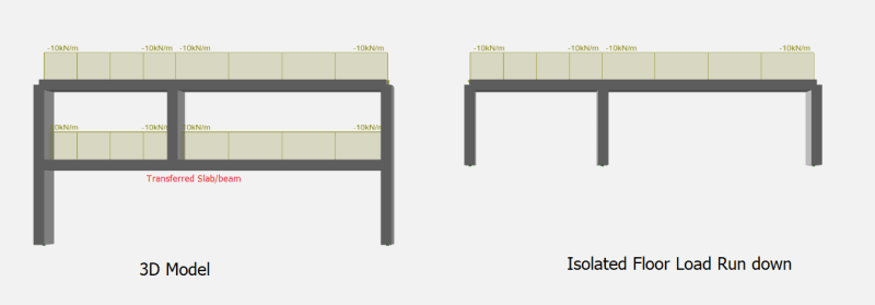

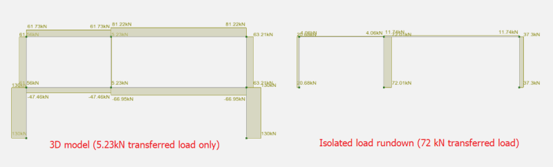

Trenno, Looks like you are talking about the difference between tributary area method with FEA and 20% is due to beam/slab continuity.
However, I think the main concern of this thread is regarding the transferred loads between full model and traditional load rundown (isolated model floor by floor). Below is the example that shows the huge difference between the transferred loads, (5+8m span with 10kN/m line load, section 400X1000). Using the later method will return a way to conservative transferred loads as the transferred slab is nowhere near a support but a spring. Put construction sequence aside, will you guys use the loads from the full model to design transferred slabs/beams? (I think enveloping these two method is not possible as the results differs greatly, not even close in most cases.

I honestly don't think you get the concern here. check the link provided by retired13 above. That example explains the main concern when it comes to transfer slab design. And there is no such a 20% sort of thing. We are talking about evaluating transferred loads not just comparing tributary area method with FEA for a normal slab due to the slab continuity.
The concern is designing a transfer structure.

Trenno, I get your reasoning behind the 20% in your method 2, but that was compared to tributary area method when evaluating the loads to each support. But the topic here is not regarding that. It is regarding whether getting the transferred loads from a full model where transfer slabs are included or from a isolated model where only upper structure are included while transfer slabs are excluded. And the difference between these two methods can be way beyond 20% and depends on the transfer slab stiffness.

I will typically look to limit the differential "settlement" between the transfer column and surrounding columns to be similar to what we get reported by the geotechnical engineer for the foundations. Using this "settlement" as the allowable long term deflection for the member supporting the column it's relatively easy to back into a spring value to use for the support in the isolated floor model. Doing it this way I've been able to get within about 5-8% difference between isolated floor models vs a full building model. In the isolated floor model, assume we are talking programs like RAM Concept or CSI SAFE for doing the actual slab design, I think having the transfer column sitting on a true pin doesn't necessarily give you a conservative slab response.
