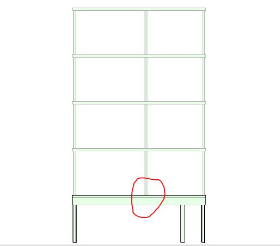

Hello,
In my project I have a row of columns, this row of columns should be supported in the beam.
My question is,should I consider / check punching shear in transfer beams
Point load = 2700 KN
Beam w / h = 100 / 110cm
Thanks in advance
What size is the column relative to the beam? Can it punch through? Exaggerated scenario if you had a 200mm x 200mm column sitting on a 2m wide beam - then yes, I’d consider punching.
I’d expect standard line shear will govern anyway if your column is any way reasonably sized.
Hello,
the column is circular with diameter =35 cm
I can't imagine a scenario where punching shear would govern a beam of those dimensions. Try drawing your failure plane, you end up back at one-way shear plane.

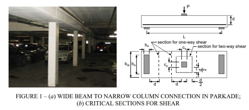

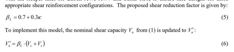

I agree that your beam probably isn't wide enough to have to worry about punching shear. That said, it will still be prudent to give some consideration to how effective the beam will be in shear given that the load will be delivered over only part of its width. Historically, firms have deal with the upside down version of this (wide beam over narrow column) in a number of ways. This was studied in 2008 and, in my opinion, the aurthors' recommendations now consitute the state of the art. You can find their recommendations here: Link.

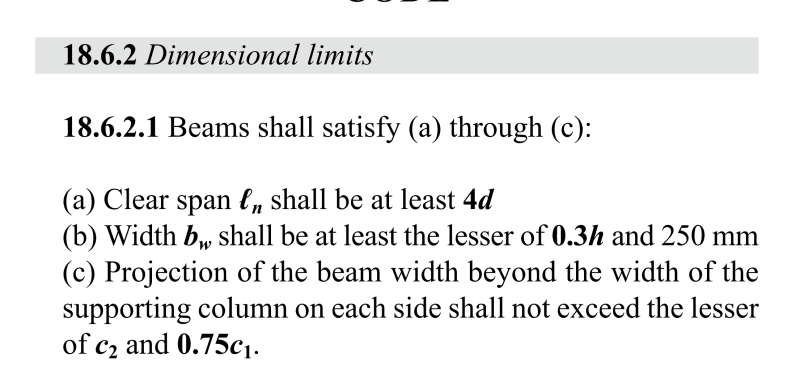

From most codes perspectives they state something like you only have an effective width of a wider beam at the joints and some of a wider beam might be considered ineffective (for both moment and shear). In ACI318-19 this is outlined in part in the dimensional limitations in CL18.6.2 (shown below). But for very wide beams that do not qualify with these provisions the code is a little silent. Clearly it can be wider, but not effective, but the question then is does it act like a two way slab, or other?
So they don't really cover to well is what to do if you want to consider the ineffective width on a wider beam as effective, for example you require the moment capacity of those bars right out on the edge of the beam to be effective, or to get the shear to work you need the full beam width considered and you might not meet the requirements of 18.6.2.
In this case you can use some judgement and detailing to add an orthogonal beam element to effectively pick up the shear from the ineffective part of the beam. In a way sort of like a corbel each side of the column but within the thickness of the beam, depending on the proportions you'd either design using strut and tie or normal flexural theory.
In your situation if you were following the ACI provisions to the letter, then with a circular column if you equated it to a square column of similar area to evaluate the dimensional considerations. Then the max effective beam width would be (1+0.75+0.75) x (π/6*350^2)0.5=775mm. So not all of the beam at 1000mm wide is effective. I'd make sure in this instance that you had sufficient orthogonal bars (and stirrups) through the column core in a similar manner to that shown in the figure below to pick up the shear outside the immediate width of the column (worked out on the basis that it is averaged over the width of the beam). This delivers the load to the column via this orthogonal beam element.
If you're just accepting that some of the beam is ineffective at the support, you need to be careful that you check the max shear provisions based on the effective width. In a way since part of the beam is considered ineffective the shear forces and moments concentrate into a narrower width at the column.
Agree with what the others said.
At the end of the day you need a sufficient number of shear legs crossing all potential failure surfaces - be it a 3D punching cone failure surface, or a 2D shear failure plane, or something in between. You don’t want the shear crack being sneaky and getting up and around your shear ties.

Note that Agent666's reference in ACI only applies to beam shear in Special Moment Frames, not Intermediate Moment Frames and would appear to apply to the column supporting the beam, not a transferring column. It appears to be very restrictive for deeper beams such as this one.
Rapt, in my opinion the concept is conceptually similar for a transfer column onto transfer beam, just turned upside down. Especially so if you're transferring any considerable moment from/to the column, typically because the transfer beam is stiffer than other beams in a system these poor columns seem to attract a much higher moment for example than others depending on overall system stiffness. If there's one thing you want to ensure is that the transfer elements are fairly robust!
While that ACI clause is in the earthquake part of the code, since nothing exists elsewhere in the code eluding to the potential issues apart from the joints limitation in CL15.4.2.4, I believe you can apply similar logic for gravity cases as you fundamentally have similar behaviour with the load trying to get to the column and an effective width scenario ensuing unless you provide an alternative load path. All it is triggering is putting some thought into the situation when your beams are substantially wider than the columns.

My disagreement was with the very small extra width the ACI318 rule was allowing, independent of the depth of the beam. It seems unreasonably small. For an 1100 deep by 1000 wide beam with a 350 diameter column to only use 775mm width for beam shear is not logical to me for an 1100 deep beam! That is basically 200mm outside the width of the column either side. I would suggest someone on the code committee needs a rethink on that one and it needs to be depth dependent also.
The ACI rule is not for all seismic, only Special Moment Frames, so ductile moment frames (the kind us Aussies do not cover in our code and have to use NZS for!). It is not even required for Intermediate Moment Frames.
