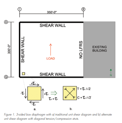

As of last year, there's a decent, free structuremag article on this topic: Link
Any practicing engineer with the ovaries that it takes to publish a sketch of a differential shear element gets my respect.

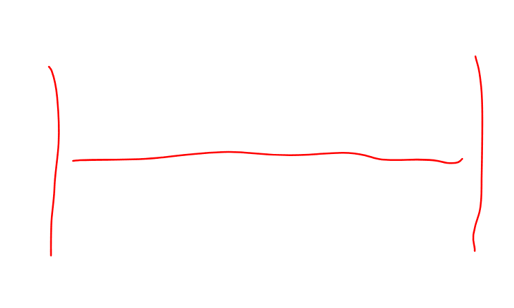

In low seismic areas, I feel pretty good with the long, three sided buildings sans portal frame. Small eccentricity aside, they wind up being not wholly disimlar to the power I shape shown below which has much to recommend it. Most of the exercise of doing it "right" for low seismic areas comes down to this in my opinion:
1) Solid design and detailing of the diaphragm.
2) Explicit consideration of the movement that can be expected at the corners of the diaphragm and how that may impact stuff that might be damaged by such movements.
