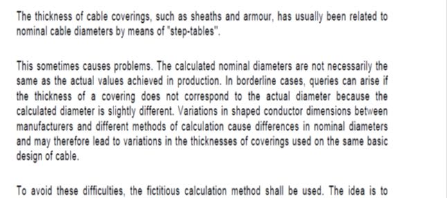

40 years ago I worked in a cable factory as a design engineer for [cable] products and production equipment.
An oil distillation company ordered a large quantity of 10 kV cables. At the same time, this company ordered all the necessary accessories - mainly cable glands - for the hazardous location based on the cable diameter in the table in the cable company's catalog.
The cable has been ordered and tested according to IEC 60502-2. No outer diameter is required according to this standard.
The overall cable diameter was calculated as per Annex A of the above standard:
Annex A [normative] Fictitious calculation method for determination of dimensions of protective coverings
From this annex it is quite understandable:
So, if the people at the oil company had consulted with us, we could have advised them first to measure the actual diameter and then to order the glands
