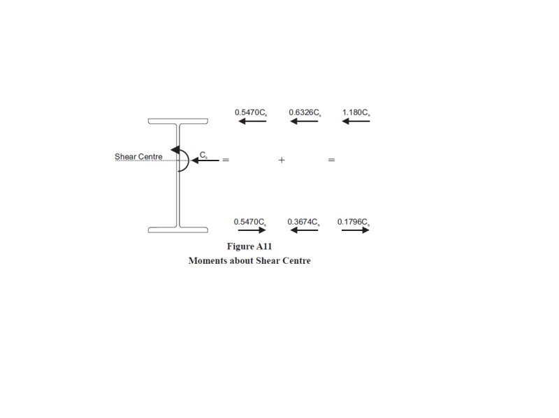

Search key words "Torsional section properties of steel shapes" and you will find a document prepared by Canadian Institute of Steel Construction. the document lists the formula of torsion properties calculation for some steel shapes including Channel plus W section.
in another way, you can just assume channel plus half W section resist the lateral horizontal force. this will avoid the torsion analysis.

one way to get around normalized warping function calculation
Decompose the lateral force the top surface of the rail to a force applied to the member shear center and a torsion. The force can be decomposed to two forces on top and bottom flange of the member; the torsion can be decomposed a force couple and two opposite direction forces will be applied to top and bottom flange.
And then calculate the lateral force effect on bottom and top section separately.
