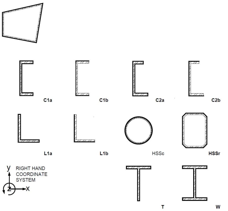

Does anyone have a good approximation for the Torsional and Warping constants for the following? [ponder]
Thanks, in advance...

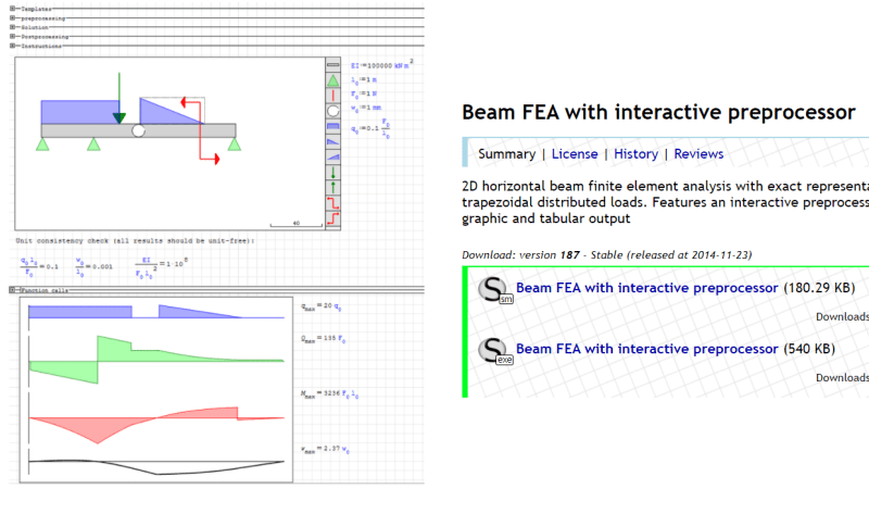

Attached is an SMath file for steel wide flange design. Also an SMath file on how to import shapes from Excel.

No problem, just let me know. Their forum is pretty good too. There is an "FEA BEAM" function that is pretty helpful. Like most other stuff, it's frustrating at first but then you learn how to work around some of the short comings.
Yeah, that's the one.
That file is more educational/fun than anything. But you can take those functions and apply them to other stuff so you basically have a beam "engine" for any calculation that you want to create. To be honest, I've spent a great deal of time getting that to work (where I could send it loads a rather than having to place them graphically) and it is kind of a work-around-work-around that I don't use very often. But it is helpful for curtain wall / storefront stuff when you need to reinforce a mullion and you have different E-I values over only a portion of the beam. If you ever get into that, I can try to cut down the learning curve.

Yes. I've attached a file where it 'works'. Unfortunately, it's not very "stable".
You will see that there are multiple "functions" at the top of the worksheet:
[ol 1]
[li]Templates for Beam Drawing[/li]
[li]Create Modeller Input[/li]
[li]Process Info for Input into Solver[/li]
[li]Beam Solver[/li]
[li]Beam Post Processor[/li]
[/ol]
It would be best to just send the loads to either "process info for input into solver" or "beam solver". However, I actually use the loads to create the graphical model and then it proceeds as if you were using the graphical model. Which I guess is kind of nice, because you can see the applied loads. Also you don't want to have any of the inputs be a "nothing matrix" That's why there are 0 loads in all of them.
This version is still considered "testing" I have a slightly different version for use in curtain wall stuff, but I need to dig that up, its linked to other stuff.
Lastly - Credit to Martin Kraska for his work on this.
