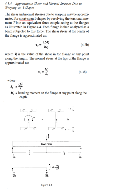

Neglecting St. Venant torsion can be done as per AISC design guide 9:
Note that this method is conservative with respect to:
1. Warping normal stress (perhaps overly conservative for long spans).
2. Warping shear stress
3. Unconservative for shear stress in pure torsion (St Venant) especially in long span members. Note that this approximation is intended for short span members, since the shear stress from pure torsion is low.
