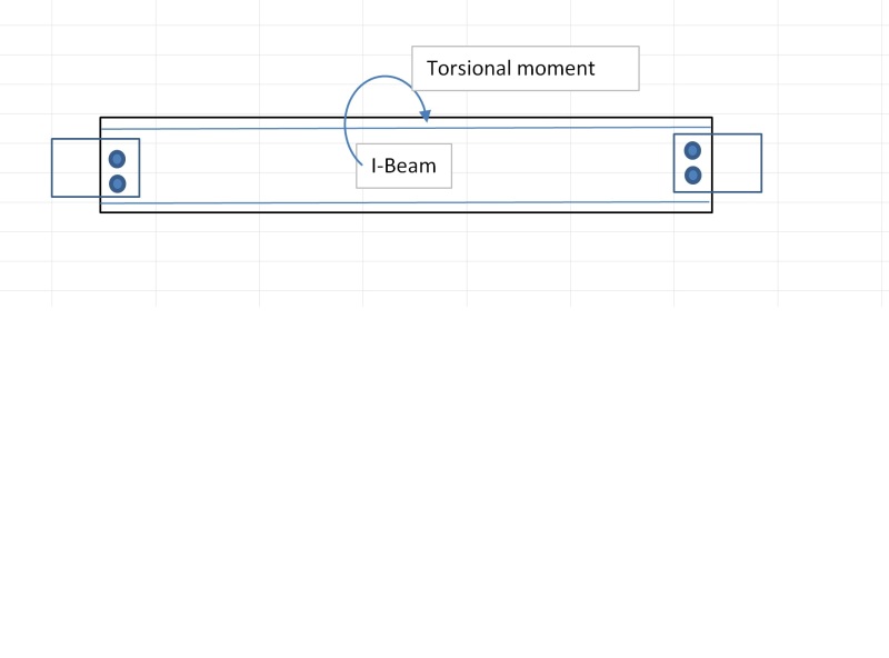

I have a simply supported I-beam, connected by fin plate connection. Will this beam can take torsion.
As per AISC design guide 9 simply supported beam takes torsion. According to me this beam will never take torsion.
Please correct me.
There will be some torsion - but only to the extent that the single plate connectors can resist. They probably have very little torsional stiffness so there would likely be minimal actual torsion in the beam.
faq731-376
The beam can take the torsion.....the ends (likely) can not. I did a study on this some years back: You typically need some type of flange restrained connection (i.e. moment; torsionally "fixed") to transfer a significant amount of torque (unless you have some intermediate/sub framing that won't let it get to the ends).
Basically with clip angle/single plates.....the torsion will go to the connection by bending in the web. The web typically can't take much.
This is what you would call a torsionally pinned end. Yes, the beam can take some torsion.
"torsionally pinned" = it doesn't work ?
I think the clips can carry the incidental torsion that arises due to small imperfections, but not any sizable torsion like from a load.
