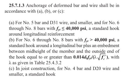

I may have just made it up somehow. The relevant 318-19 provision is below. The mechanisms in play, as I understand it, are:
1) Sort of a mechanical grabbing of the longitudinal bar by the stirrup hook to improve anchorage. I find this a bit dubious frankly.
2) Limiting transverse beam crack widths in the vicinity of the anchorage and, thus, improving its resistance to splitting.
