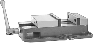

The clamp you show is for restraing a part whos features are below/above the face being milled. You need a milling vise that secures the object from the sides!View attachment 6273

I don't agree. It is quite common practice to use strap clamps that are present above the top of part; talk to any mold maker. That's one of the things that collision avoidance is used for.
Besides, this part is too large for a vise (16.5" SQ x 3" thick) and strap clamps offer more holding power in this scenario.
