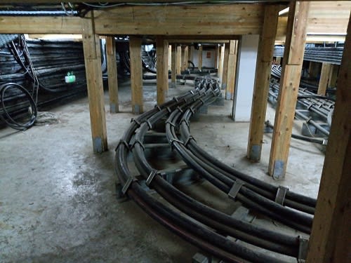

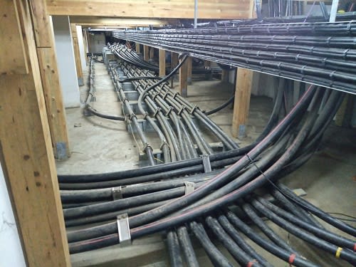

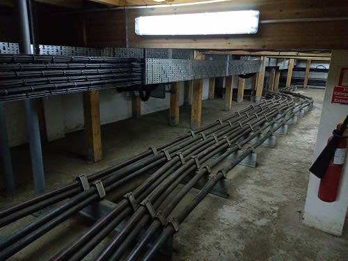

Our insurance has requested to install water sprinklers in an electrical substation. Please see attached picture.
Is this a common practice? On top there are electrical panels. In case there is a broken sprinkler bulb water may spread inside electrical panels. Please advise. Thanks
Wood?
How about a pre-action dry system that allows you to trip everything before the water hits anything?
We have 2 power plants. A cable on one unit may fail while the other unit is operating normally.
There is no reason you can't interlock the protected zone so that it is de-energized in the event of a deployment of the fire suppression system.
I'm surprised about the use of wooden construction here.
I have seen high pressure fog systems installed in electrical applications.
The high pressure atomizes the water and the result is that there is very little water used.
Suggest FM200 instead of water. Perhaps insurance can be convinced once you explain the lack of water damage to the panel equipment.

The equipment is a mix of electrical motors, hydraulic pumps, junction boxes and cables.
