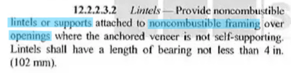

In TMS 402-16, sections 12.2.2.3.1.2 and 12.2.2.3.2 (sorry, dyslexics) limit the height of masonry veneer supported on wood to 12 ft, and require lintels over openings to be supported by non-combustible framing where the veneer isn't self-supporting. I point to these provisions semi-often to get architects to let me have a couple steel posts and a tube header, but since the veneer chapter re-write in the 2022 code, I don't see this addressed anywhere.
Am I overlooking it? If not, why would this restriction have been removed?

This makes sense to me. Thanks for the response! I think you're saying they eased the code restriction back and let the engineer be responsible for considering the differential movement instead of the code imposing a low limit.
However, what is still confusing to me is the removal of this section:
The situation that prompted me to go looking for this in 2022 was an exterior wood-framed canopy up against a veneered gable wall. The architect had drawn the brick sitting atop the canopy roof framing and over an exit:
I always read the above section as meaning "don't support veneer on combustible framing over an opening b/c fire safety." That section is now gone, and I wish it wasn't/wonder why it was removed.
Of course, the easy answer to this is - don't support the masonry veneer on the wood at all and let the canopy be self-supporting. :) I do feel that in the past, supporting brick on wood in any way would be a cause for concern from a fire standpoint. That mentality isn't as evident today, not sure why, and not shared the same as everyone.
Right on, I don't intend to, code provision or not. The fire issue scares me a little too much.
I would hope removing that code provision (which only implies the concern to begin with) doesn't kick that can further down the wrong road.
