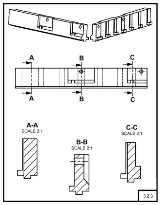

Hi all - just a quick question.
Is it mandatory per ASME standards to add a view title to an isometric view? I'm not seeing anything in Y14.3 that would indicate this is a requirement. Normally, on our drawings, I see
ISOMETRIC VIEW
FOR REFERENCE ONLY
Just curious if there's an actual ASME requirement to do this. We end up putting ourselves into a situation of generating non-value added redlines when someone forgets to put the above note below the ISO view.
If you look into ASME Y14.3-2003 MULTIVIEW AND SECTIONAL VIEW DRAWINGS you will see that isometric view is NEVER given a title:
Naturally, notes can be added if the view is made not to scale, placed on different sheet, etc., etc.
CheckerHater
"NEVER"?
I usually do not apply titles to drawing views, since it generally is obvious what they are. If I have notes or a separate document that refer to drawing views, then the views need to be labelled.
JHG
I take it you only read first line :)
