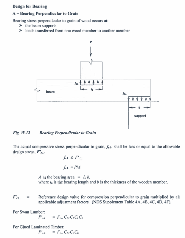

You could check the bearing stress perpendicular to grain for the wood at the beam support. See below.

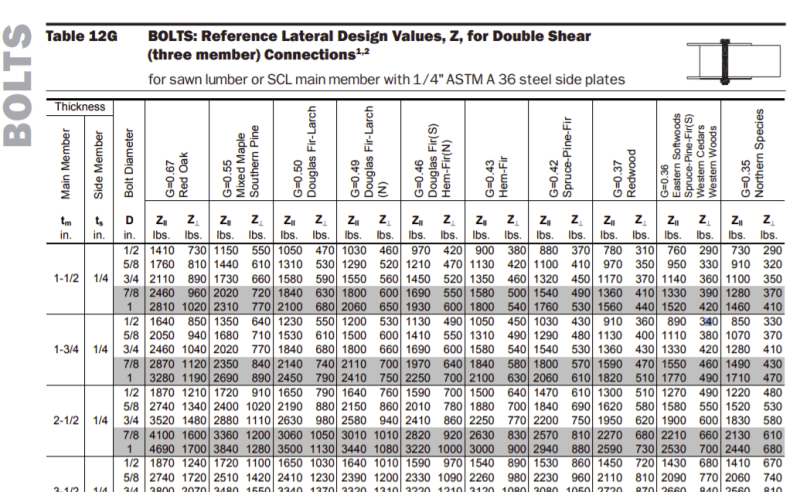

For the bolts you'll need to check their capacity for the uplift load. You can get double shear design reference values for load perpendicular to grain in the main member. I think the table below would be the one you'll need from NDS 2018. But you'll have to use the correct adjustment factors to modify these reference values based on your bolt spacing and edge distance.
For uplift you need to check for the appropriate loading direction on the bolts, and make sure you meet the minimum spacing requirements to engage the number of bolts you need. The failure mode in that case is splitting perpendicular to grain. 32 kN is quite a bit. You may need to strap over the top of the beam if it turns out you need a signficant number of bolts to make the uplift work.
