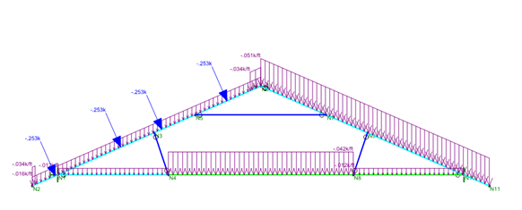

I am doing a solar panel on roof design. I have been asked by the plan checker to show the analysis of the thrust on this system. I must admit I’m not exactly sure what “thrust” is in this context. Is this additional outward force applied to the walls by an increase in load on the roof?
This particular residence has two roof shapes,

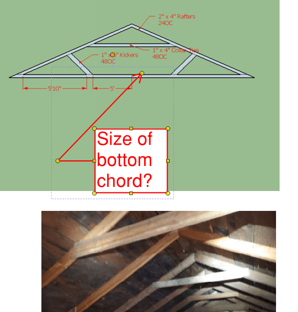

1) Typical roof, with rafters, rafter tie, collar tie
2) Vaulted ceiling with rafters, beams and intermediate columns supporting beams.
In condition 1, there would be no thrust as the load is being handled by the tension capacity of the collar tie.

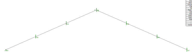

Pinned left side, roller right side.
I would go under the assumption there is no additional thrust in condition 2, because all the load is being directed downward through the intermediate columns.
Pinned left side, all other reactions are rollers
Based on what I’m seeing, there isn’t a reaction in thrust, unless make both ends of each rafter pinned. Is that the right way to determine loading? Thank you.
I don't see a collar tie in condition 2. I see a collar tie and rafter tie both in condition 1.

Condition 1
Condition 2
Condition 2 does not have thrust. Thrust is generated outward due to sagging ridges.
If you want to know the thrust load, both of your support points should be pinned and the horizontal reaction equals the thrust load. By putting a roller on one end, you are eliminating thrust, but that's not realistic because the connection to the wall is not a roller.
Your wall supports cannot be pinned. Wood framed walls cannot resist thrust from the roof. Set your horizontal restraint at the ridge. Your thrust will be the horizontal deflection at your vertical supports. You need to make sure that deflection doesn’t exceed your code deflection limits based on the height of the wall.

I understand what you are saying, but I am not sure I agree with it. Whenever I model this type of system I have one support as a pin and the other as a roller. I understand the model isn't perfect, but I believe that's as close as I am going to get it.

A) Model the truss system w/ pin at 1 bottom point
B) Model the system w/ pin at center point.

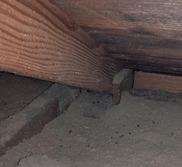

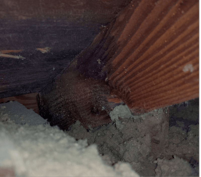

I've just received photos of the roof system, and I'm sorry to say there is no direct load path from the rafter tie to the rafter. How common is this construction type? Guess I'll need to make sure they are both well connected to the top plate.
(Interesting not is the 2x decking used as a roof material)

I would like to clarify that Fletch10 did not state to model with a pin at the center/ridge, he/she said to restrain the ridge horizontally (not vertically). Both of these methods should produce similar results.
Oh! I see. Think I would have figured it out when I opened back up the Risa Model.
I believe both of these options are valid.
With chris3eb's method, you would model it without the rafter tie, the resultant horizontal reaction is the thrust the rafter tie needs to resist.
With the pin-roller method you would model it with the rafter tie, the resultant axial load in the rafter tie is your thrust
