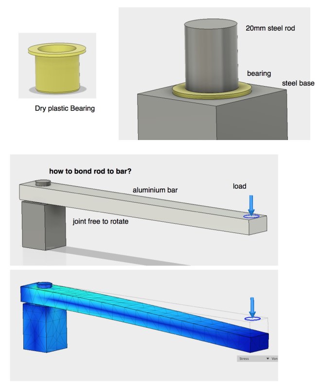

A 20mm steel rod is held vertically by a dry plastic cylindrical bearing such that it can rotate freely in the horizontal plane.
An aluminium bar with a 20mm hole in it is slipped onto the rod and, supported by the bearing below, can rotate freely in the horizontal plane.
The bar must support a load and in order to distribute stresses at the interface between the aluminium bar and the rod it would be best if they were bonded.
What are the options for bonding the aluminium bar and the steel rod? Or other means for reducing stress concentrations under load?

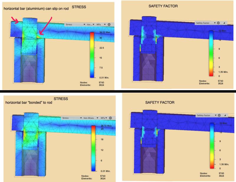

@Tmoose Stress scale just about visible in below image. Point of concern are those in the aluminium bar (red arrows) which seem reduced in the case connection with rod bonded rather than slipping.
Plastic ring used in this model has max tolerance of 35MPa, but that's the lowest rated of the Igus Dry-tech 20mm bearings. Also steel rod will pass through another similar bearing lower down....
Mostly concerned about the Aluminium to as to reduce the chances of deformation in case someone mischievously overloads the system. The combination of machining & installed electronics (not discussed here!) make it relatively costly whereas the plastic bearing could cheaply be swapped out.
You could press the steel rod into the aluminum bar. ... but I don't trust that joint. It looks like something that will disassemble itself upon being loaded. You seem to be relying on a short bushing to transmit and resist what looks like a fairly large moment.

@MikeHalloran those are just CAD models with "bonded" defined in software.
In "reality" the rod will reach downwards further and above will be flush with the top of the horizontal bar.
I did have a prototype quite similar and surprisingly the bar didn't seem to work upwards under load, though I couldn't be sure.
Nevertheless the plan is to have the rod fixed in the aluminium and looking for ideas.

Be aware that a threaded joint is not the same as "bonded". (The threaded joint has one DOF - rotation about the joint axis). Consequently the threaded joint will not solve the stress concentrations shown in your FEA in the way the "bonded" FEA joint does. A tapered thread might be an exception.

I would add a flange to the pin, and bolt the aluminum arm down. Taper is an added bonus, but not necessary in this case.
I would go with a taper like a bike crank arm and a single central bolt. A bit of lube on the taper will minimize fretting and ease disassembly.
Making the Al bar thicker, even if just near the joint will help greatly.
