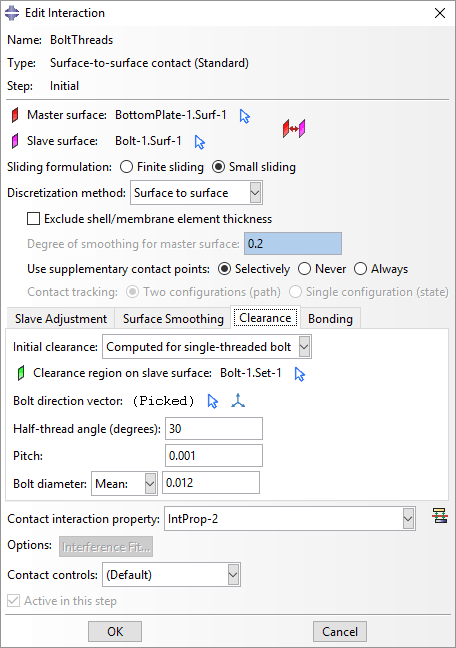

I am trying to simulate threaded bolts using Clearnce tab in the Edit Interaction dialog box but no success. Could someone please have a look at the attached input file and let me know what is wrong with my model.
