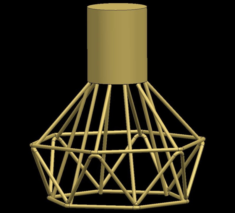

Wanted to produce this 'light shade' ornament thing.
I am a great novice at CAD, my steps to produce this were as follows:

This is where I am stuck as to what the most efficient approach is.
If I extrue I obviously get a solid and would have to create a lot of sketches and subtract areas.
I was looking at using Ruled but this creates a sheet. What would you suggest in order to achieve the wire frame feature?

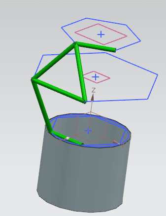

this type of questions are tricky, i have difficulties not to try find a reasonable solution...
The geoometry is 3 planar hexagons, connected by straight lines.
Three sketches, hexagons, on three planes, 2 of these offset from =0;0;0
Then three lines to connect between the sketches.
Tube features on the three lines + 3 lines from the 3 sketches
Geometry instance, circular of the tube features, n=6, angle = 60
- Simpler solution, anybody ?

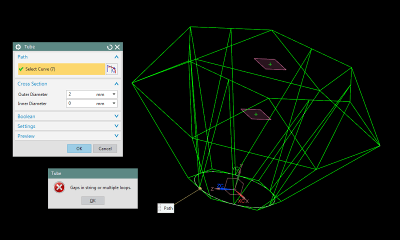

So I created the three sketches across three planes.
Sketched a curve in 3D space.
Attempt to use the tube tool, get an error:
Gaps in string, I am stuck.
Any suggestions?
I think I will try sweep along a guide.
The tube command does not like sharp corners. You will either need to create them individually (such as in Toost's pic above) or add smooth transitions between the lines that constitute a single wire (as in the original photo, you can see the bends in the wire that goes around the circumference).

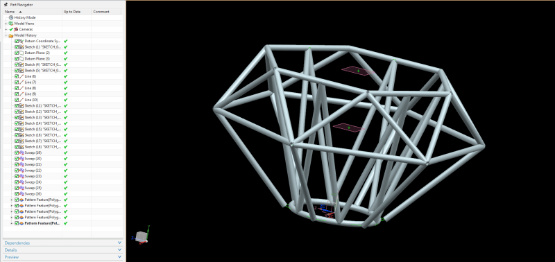

I attempted sweep, it worked well but still ended up with corners being an issue, after patterning I have 1 corner which fell short and did not intersect (faces just touch) then every other corner was too blended and I had no solution to trim the corners in to one.
For reference this was the result from sweeping and patterning. The corners do not fully join and I can't figure out how to extend if that's necessary.
