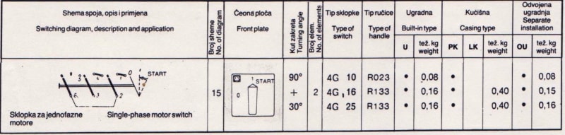

You can replace the centrifugal switch with some kind of external manual switch with three positions: 0 - 1 <-- start.
Also you need to check the auxiliary winding, in case if there is no run capacitor.
It is designed to be energized during the start only, as well as starting capacitor.

But I was also thinking about what someone else in this thread suggested: bypassing the centrifugal and wiring a switch that will trigger the start, and stay on for the run. Like a OFF/MOMENTARY-ON/ON switch? Don't even know if such a thing exists. Or what about a separate ON/OFF push button just for the start capacitor circuit? Push button and hit the power switch at the same time, release button when it starts spinning...just spitballing here.
Of course they exist. Just about every dryer on earth has one. It's the knob you have to twist and hold until the motor has fully started.
