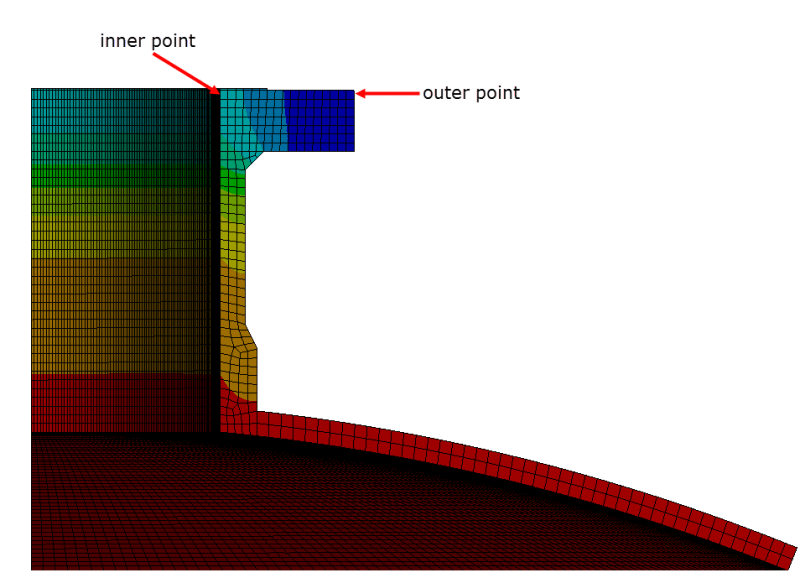

TGS4, for one special case I have a vessel which is operating at 48 C and suddenly a gas of 280 C starts to enter the vessel for regeneration process. I assume the vessel wall and all metal being in 48 C initially.
The above image is the contour of temperature distribution in a transient thermal analysis. The model is actually the inlet nozzle and spherical head for a pressure vessel subject to cyclic loading. When the temperature through the thickness of the nozzle neck and the self reinforcement is considered versus time, the temperature difference starts to increase at the beginning and then starts to decrease after some seconds. so I consider the maximum temperature difference to be used in the exemption calculations. The through thickness temperature difference will be maximum 8 C for different locations of the model. However my problem is when I want to consider the temperature difference between the inner and outer edges of flange face. First of all it takes a much longer time for the temperature difference to reach its peak value (more than 500 seconds of transient thermal analysis). Second is that I do not know if these two points are considered as adjacent points as defined by VIII-2.

What are these two points? are they through thickness points or are they surface meridional or circumferential points ?
Another question is what is meant by ΔTEin method A of screening for fatigue calculations. Suppose that I have two cycles for the first one the inner surface is 8 degrees warmer than the outer surface and for the second one the inner surface is 15 degrees colder than the outer surface. Do I have to consider the value to be the maximum of the two cycles (i.e. max(15,8)=15) or the sum of them (i.e. 8+15=23).
