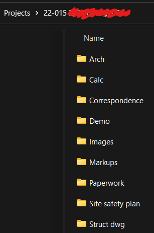

@Brad805 The basic file structure for each project is something like this:

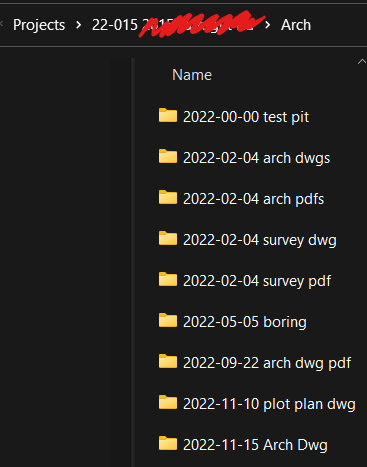

The folders themselves would be subdivided with dates, and unused items with 2022-00-00 to be initialized later (it functions kind of like a checklist when everything is 2022-00-00 "something here" at the beginning of a project):

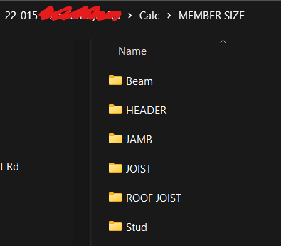

Calc folder was shown in the beginning of the post. It generally has empty folders that get filled in (mainly to serve as a checklist). The folders in each calc may be subdivided as well:

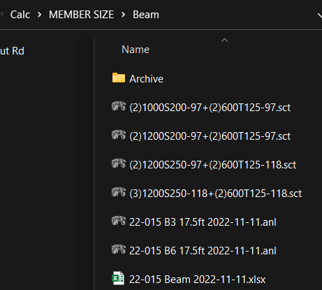

In a calc folder with actual calculations, files that might change over the course of a project have the date in the filename (like xxxxxx 2022-11-17). I found that in most cases, putting it at the end of the filename will sort it better. In some cases where date is the primary objective (like with invoices), it's better at the beginning. Some judgment will be needed there. For files that definitely won't change over the course of any project, like the section profile of a member, it's better without the date. When modifying a calculation, we always put the old one in an Archive folder and new one with today's date.
I don't generally sort the calculations by the program used to make the calculation (except for ETABS and SAFE for good reason). Taking Enercalc for example, it could be used for beams, columns, etc and you'll end up with a million different types of calculations in one folder. That wouldn't follow the principles of using a physical binder. Regarding ETABS and SAFE, if it's used to design one component of a building like a single beam, it would still go into the beams/truss/stair beam folder and not the ETABS folder. The ETABS folder is reserved for gravity and lateral analysis FEM model only.
Regarding file naming, it's also important to label the components in an Excel file (I showed a screenshot in the original post) and have that correlate to a file name. Since this is internal to the calculations, it doesn't have to match the naming scheme on the actual drawings (because a drawing can have several W10x33 but the calculations will be different for each one, so I notate them as B1, B2, etc). It does help to specify the floor in the filename with columns/studs/walls. Finally, stair beams/headers/jambs: I have Excel sheets that have certain inputs (i.e. size of stairs, load, span of beam, length of landing, etc) that can almost completely define the size. So where it's possible, I put it in the filename. For example, it would be something like "3FL stair beam A25 B8.5 C4.5 D50 L100 2022-11-17".

My OCD is screaming out internally at you regarding the mix of all caps and title case folder titles.... What possesses someone to do such a thing [ponder]

@Agent666 That used to drive me up the wall. Several people work on the same project, so there's some mishmash. Not everyone is fluent with computers; some learned at an old age, so there are anomalies. As long as they follow the naming conventions (which was hard enough), I'll let the capitalization slide. I learned to pick my battles.
Folders as a checklist is an interesting idea. I'm going to have to think about that. I like it, but I think I'd end up having problems if things are split up too much and I can't see as much in one place.
@TLHS It doesn't replace actual checklists but it helps. Yeah, you have to find a system that works for you without splitting things up too much. I happen to have a lot of similar projects (with constant elements like architectural drawings, borings, paperwork, etc) where it makes sense this way. I also have to split up financial stuff from the project itself to hide the $$$ info from employees, which is a necessary headache.

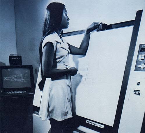

Back in 1977 we installed our first CAD system. It had a CalComp plotter:
Now this cost approximately $50,000 (in 1977 dollars), and this was one of the cheaper options. Flat-bed plotters, which were also used at the time, could run over $100,000. And having to keep the pens working was almost a full time job. Every night we had to remove them and place them in a special canister which keep the nibs moist so that they wouldn't dry out. And then the next morning, put the pens back, test them to make sure they worked and if needed, we had to clean them and refill them with ink. And these pens were not cheap, $25 or so and if you plotted on Mylar, they wore out pretty fast, and then you had the cost of the Mylar. Even regular velum wasn't cheap. So we didn't make any more plots than we needed.
Then in the early 80's, HP decided to get in the plotter business and their first models were in the $14,000 dollar range, and ran much faster and used cheaper pens that worked longer because of how they were 'capped' when not in use.
Then eventually people like Xerox started to produce large size electrostatic printers and the cost per plot dropped again.
