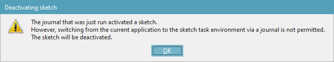

The automation script I have developed is trying to active an existing sketch using the code:
sketch.Activate(NXOpen.Sketch.ViewReorient.False)
The sketch is activated but sketch related tools are not visible(i.e., Sketch workbench UI not visible)
To get the sketch workbench / UI, the user must navigate to Menu-->Edit-->Sketch
Similarly, while I try to deactivate the sketch through code the Sketch workbench / UI is not reverting to the previous status
The code used is:
theSession.ActiveSketch.Deactivate(NXOpen.Sketch.ViewReorient.False, NXOpen.Sketch.UpdateLevel.SketchOnly)
i.e., The sketch has come out from the edit mode, but the UI still shows with Sketch workbench tools
Note: I am using NX1946
Please help me to solve the issue
Are you using the new sketch solver or the classic solver? Also, does the journal modify the sketch in any way or is the purpose just to activate the sketch so the user can make edits?
www.nxjournaling.com
Hi Cowski,
Thanks for your reply...
We are using new sketch solver. Yes our tool will just activate the sketch(by code) then user can make his edit. after that tool has to deactivate the sketch(by code).
It appears that switching to the sketch task environment is not supported by journaling. I don't have NX 1946 installed, but I got the same result in NX 1919 and 2019.
If all you want to do is activate a sketch, you might be able to do it with a macro instead of a journal.

Switching to the sketch task environment is not supported because of the new sketch solver? or the classic sketch solver also has the same issue?
I'm using the new solver in 2019; the old solver is the only choice in 1919. So, it appears that both are affected.
