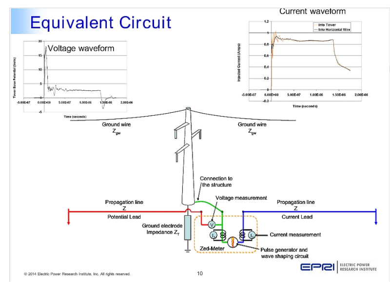

Anyone here has experience with measuring ground resistance of tower/ structure footing? What testing tools are typically used by utilities to determine the footing resistance? We recently had few back flashovers on our power lines, so we are doing the root cause analysis and starting with the structure footing resistance.

Thank you everyone for the suggestions. We are currently evaluating this product by EPRI which seems to be specifically designed to measure the grounding performance of the electrode by simulating the lightning surge.
I can't imagine a better tool for flashover impedance measurements using ground references approx 100 m in either direction to measure voltage and current from a safely induced spike to the tower. (unless it also measured PD (partial Discharge) the precursor to corona, hint hint)
I wonder what Quebec Hydro is using (?) but I did see among the evaluators, my current and former suppliers listed for their contributions during evaluation. Hydro One and Manitoba Hydro) Duke also uses it.
Fundamentally it measures V(t)= I(t)R + L dI(t)/dt then the ratio of V(t)/I(t) is impedance Z(t) which may be converted to frequency domain. The time constant for inductive wire is Tau=L/R (63% of target) then there is an air ionization time that depends on path length and capacitance. Lightning tracers are a chain reaction of PD to ionize the air with low resistance then the follow-on return arc goes at the speed of light and ultra-high current limited only by the tower resistance which might be around 5 ohms.
I recall long wire is about 1 uH/m.
This test measures the impedance before the next tower ground can react due to the rise time of the pulse is shorter than the T=L/R.
The standard method relies on the characteristic impedance of ~ 100 m cable over soil which has some distributed coupling capacitance to ground such that the impedance is measured for at least the 300 ns flat portion of pulse before the reflected wave occurs from the cable end. (although it could have been terminated to prevent that) 200m/2e8m/s = 1e-6 s or 1000 nano-nano seconds. ;)
