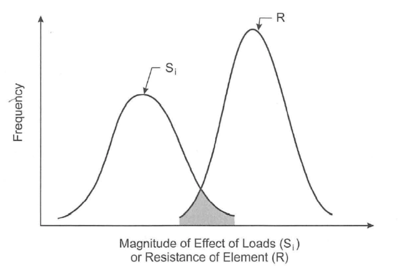

If I am not mistaken, coefficients of reduction of material are used to account for the probability of a material with a lower strength than the average.
The CSA S16-19 Design of steel structures specifically says that "Xu = ultimate strength as rated by the electrode classification number". This code is for design only. In my case, I am doing a structural evaluation, however I haven't found see any code provision for structural evaluation, so I will use the design code.
