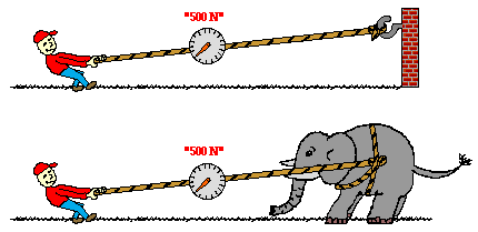

The forces on the 2 abutments are equal. That force is the force required to deform the elastomeric bearings the thermal expansion or contraction movement of the full superstructure length.

Son of a Bridge said:
...please explain why the forces would be equal if each abutment has a different stiffness...
Physics, Newton's Third Law of Motion:
SRE beat me to it.
It's a single span bridge, so the abutments alone provide equilibrium. In your case, when the superstructure expands or contracts, it moves and reaches a new center point, based on the overall stiffness of the restraint at each abutment. Typically, where there are elastomeric (or any other type of expansion bearing) we assume the abutments are fixed (infinitely stiff and unmovable). This is slightly conservative, because nothing is infinitely stiff, but the relatively low shear stiffness of the expansion bearing makes it a reasonable assumption. Under that assumption, if a temperature change produces a 2" length change in the superstructure, there will be 2" of movement at Abut 1, 1" at the center of the span, and zero movement at Abut 2.
