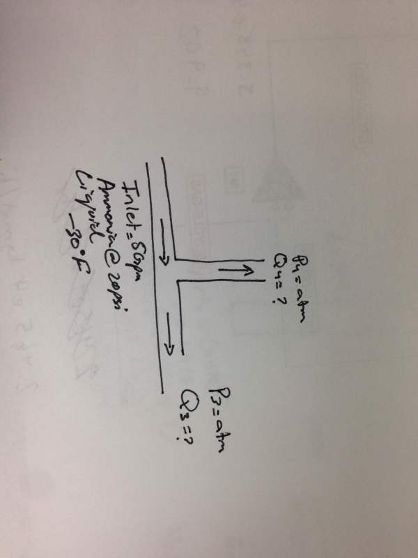

I would like to know the diverging flow of the two outputs in a tee if I have a incoming flow of Liquid Ammonia @ 20 psi.
It depends almost entirely on whatever is downstream,
both from the other run and from the branch.
I.e., you have to model the whole system downstream of the run inlet.
