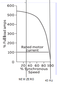

Here is a starting current curve from the Cowern Papers.
At 1300 RPM you are at about 72% of synchronous speed and the slip is about 28%.
The portion of interest of the current curve is to the right of 28%.
We are interested in the slip speed or frequency. You must reverse the numbers across the bottom of the curve. Zero percent speed equals 100% slip. 28% speed equals 72% slip.
At first it may seem as if the reduced frequency and voltage have made little difference, but the curve is in percent, not absolute values.
The applied voltage is about 74% of rated voltage so the current may be expected to be about .742 or 55% of the normal starting current.
But it's not 74% of the rated voltage. The frequency is also reduced and the rated voltage follows the frequency reduction. If you take a motor and apply 1/2 the nameplate frequency then that motors operating voltage is also 1/2 of the nameplate voltage. If 470V/60Hz is the final operating point, then 337V is the rated voltage for the motor at 43Hz.
My guess right now is that you'd just slide the curve to the left the percentage of frequency reduction. @ 43Hz, 28% on the curve becomes the new 0% speed, or the motor operates on the curve from 28% to 100% equaling 0Hz to 43Hz or 0rpm to 1290rpm.
That's what I was trying to say. Thanks for the additional explanation.

I couldn't understand what you were trying to say about the curves.
So, what about the current @ 43Hz? A VFD just slides the curve, it doesn't reduce the current curve. This generator is doing the same thing. I'm thinking the 0rpm inrush @ 43Hz to be the same as the 28% speed inrush @ 60Hz.
I can say with complete certainty it won't reduce to 55%. With a fixed 60Hz, the torque is the parameter that reduces by the square of the voltage or by the square of the current. The torque would be 55% @ 74% rated voltage only if the frequency remained 60Hz. The current would be 74% @ 74% rated voltage only if the frequency remained 60Hz. Neither of these will be true with the frequency at 43Hz.
Yes Lionel I did make a mistake. I was going by a chart for reduced voltage starting methods, but it was unclear that the chart showed running current, not starting current. Possibly for centrifugal pumps.
(My source was the Cowern Papers)

I think "100% synchronous" must be when the motor synchronizes with line frequency.
Zero speed = Zero% synchronous, so starting current is not changed with this scheme for DOL starting, regardless of frequency.
As long as the generator does not trip or stall on motor start, this should work OK on a pump or fan, providing the AVR is programmed to follow volts per Hz as discussed above.
I do not think this scheme would be appropriate for a constant torque application, like a hoist.
FacEngrPE; You can't scale the curve. You must truncate it on the left side.
For a VFD
The easiest way to visualize it is to change the % of synchronous speed to slip RPM or slip frequency.
The numbers will then increase in the other direction.
Zero speed becomes 60 Hz slip or 1800 RPM slip.
Find the slip RPM or slip Hz that is of interest and discard the part of the graph to the left of that.
For a VFD, you may be left with the portion that was originally from about 1700 RPM to 1800 RPM.
On a 1750 RPM motor that corresponds to about 200% load to no load, at any speed.
This is assuming that the VFD is set to a 200% current limit.
For this application, discard the portion of the curve to the left of 43 Hz SLIP.
And yes, the reduction of starting current will not be reduced very much, but the starting load on the generator will be reduced as the kW demand will be less. (I am still backing away from the chart that originally mislead me.)

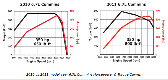

waross Tables are easier to read when the axis is labeled correctly. % slip is not the same as % synchronous, as % slip will add in the impact of torque (inertial and shaft). Of course this only matters for a case like this where the power supply has varying frequency. Thankyou for reminding me.
I like your idea of starting the generator with the generator solidly connected to the motor, with already having a Voltz/Hz AVR the only real issues are capturing every component that needs to be powered on a black start, and ensuring the generator has enough low end torque to not stall, and accelerate to operating speed fast enough that neither the motor or the generator overheat. It helps that centrifugal pumping torque is always small at low shaft speed.
This is an example, use the torque curve for your diesel.
