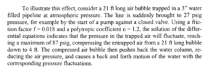

Hi.
I read in "Piping and Engineering" by George Antaki the following example:
Can anybody explain how the trapped air pressure can rise above the hydraulic pressure?
Thanks?
