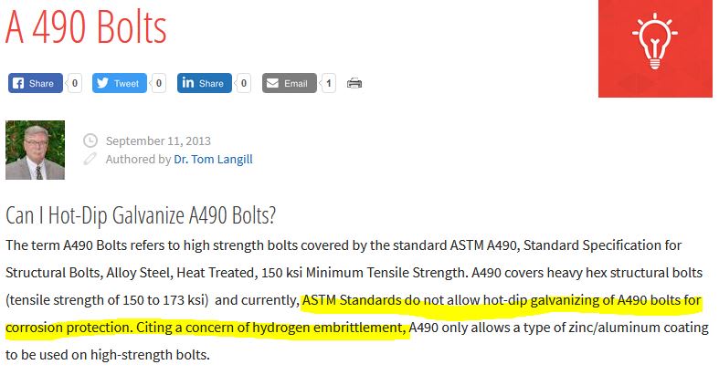

Did they ever determine the cause of the hydrogen embrittlement?
Possibly:
galvanizeit.org said:
...steel with ultimate tensile strength greater than 150 ksi may exhibit hydrogen embrittlement due to a tight grain structure trapping hydrogen molecules readily available from the pickling acid used in the galvanizing process
Source: American Galvanizers Association: Link
Unless something changed in the last 8 years, they aren't supposed to be hot dipped for that very reason:
[URL unfurl="true"]https://galvanizeit.org/knowledgebase/article/a-490-bolts[/url]

The automotive industry got smart decades ago and started using Magni 565 coatings instead of galvanizing on their high strength chassis fasteners. It seems more recent structural applications are starting to favor high strength fasteners and the experience just hasn't caught up. Eventually they will learn to not galvanize high strength fasteners. Interesting to me, the joint appears to be well coated/sealed and corrosion resistance of the fastener shouldn't have even been a consideration.
TugboatEng - I can't speak the decision to galvanize these, but the experience you mention has caught up. See the last line in the post I made earlier. "A490 only allows a type of zinc/aluminum coating..."
Magni 565's data sheet says "Magni 565 is a chrome-free duplex coating that combines an inorganic zinc-rich basecoat with an aluminum-rich organic topcoat."
Of course in this case it sounds like they hot dipped it anyway if hydrogen embrittlement is really the cause. I would speculate, however, that it's substandard bolts. They mentioned that the bolt failures were more-or-less isolated to certain sections of the structure. That bridge was a series of prefab elements that were manufactured at a variety of yards (including one here in Hampton Roads) and shipped to the site by barge. It's possible that one of the yards had a bad supply of bolts. I repeat, this is speculation.
I thought everyone was well aware that A490 aren't to be HDG... The bolts appeared to have a Dacromet type of coating system. Were the bolts HDG?
