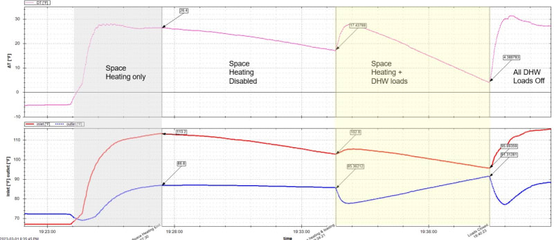

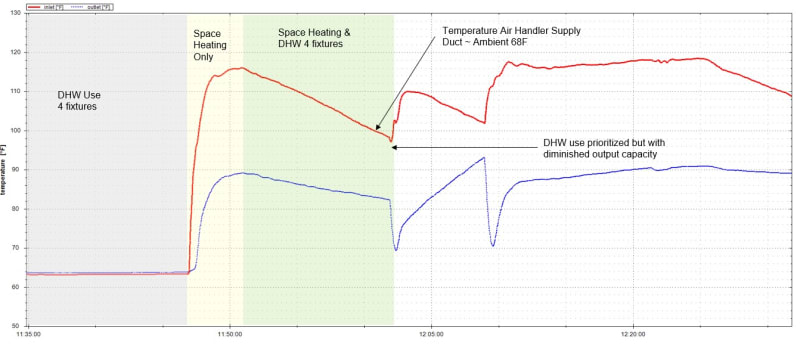

@HVAC_Novice: yes it's the detail from the manufacturer. As noted earlier, it's a new build (4 years roughly). The plans approved by the local municipality showed a 199 kBTU/h unit whereas they installed 160 kBTU/h. They don't have the same capacity obviously. Hydronic coil draws 2 GPM steady when heat called. Otherwise when heat not called it's in the re-circ loop that's mixed with the DCW supply that you see running here back into the tankless unit. To no surprise, once you start using several DHW loads (as it's prioritized), the air handler water inlet temperature drops, blows ambient temperature (or cooler) air through the supply trunk (from blower fan).

@ LittleInch: Yes the pump (Grundfos non-submersible circulation pump) only active when heat called. I believe there is intermittent operation to prevent Legionella.
Schematic here (not entire property)- not showing the DHW loads (eg. shower, faucets, etc)
That's not what I asked- I said does the circulation pump turn off when there is DHW demand? If so maybe just disable that part of the operation. or set the turn off level a lot higher. It's not clear how the system knows to prioritise the hot water system though - Is there a flow meter somewhere?
Apologies LittleInch.It must when there is DHW demand (presumably)?. All I've measured are with temperature clamps a fairly rapid decay in the inlet temperature of ~ 2.5 °F/min to the air handler coil and the temperature in the outlet increasing (which presumably means it's not moving through the coil here) and through the pump into the re-circ loop. These inlet and outlet temperatures were measured with contact thermocouples (k-type). Testo 115i.

But the solution is still the same and that is to decouple the circulation pump and either just run it all the time and let the fan do the room temperature control / on / off fan or couple it together with the fan, but then somehow you need to run it occasionally during summer, with no fan to avoid killing yourself with legionnaires disease....
Or just turn the fan off when the pump goes off so that at least it doesn't blow what you perceive as cold air (actually its the same temp as the room but blowing it makes it seem "cold") although there could be some fresh air being let in as well?
