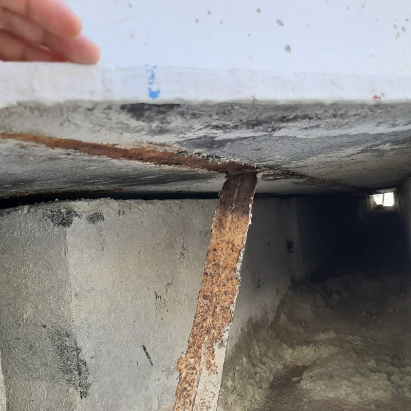

I have a 20 year old steel tank designed per API 650 with the following caracteristics:
- Stored fluid : Phosphoric acid
- Foundation : pile foundation system
- Coating : rubber inside coating
- A mixer is mounted on a steel bridge over the tank for continious stirring (6 rpm)
I have recently encountered a failure in the tank bottom throughout the backing strips (view photo)

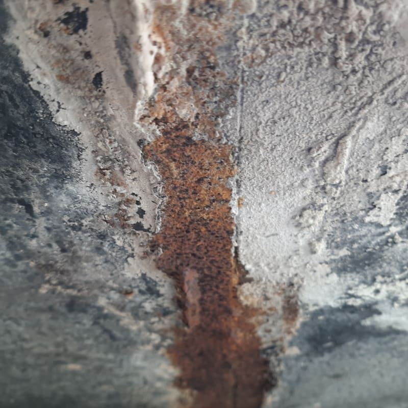

PS: After inspection of the downside of tank bottom, I have noticed a degradation of the backing strips
Tank experts, could you please identify the origin of the failure and give me your recommendation on the repairs that must be executed
Thank you
 https://files.engineering.com/getfile.aspx?folder=e418b9d7-28f6-4eba-8011-9402e620b818&file=20200911_093200.jpg

Please find attached a photo of the tank downside bottom showing the degradation of the backing strips
I could not see the picture?...I am online now..
sorry i am havin a problem uploading the photo
Dear ali-gct-meca (Industrial);

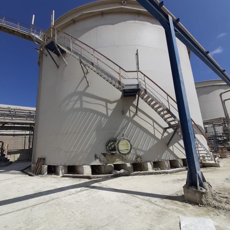

I looked to the photos. Phosphoric acid is highly corrosive for the CS. This is typical corrosion of weldment. Apparently, the rubber lining is leaking and the acid penetrated to butt weld and seems concrete raft slab also deteriorated . The gypsum build up under the tank bottom between dwarf walls implies this is an old event an it is strange nobody seen the leakage ? I could not see any berm around the tank..the last picture shows there is another similar size tank ..Is there a common dike ?
I will suggest ; the rubber lining at the bottom shall be removed (at least leaky zone ) and corroded bottom shall be checked. If the remaining thickness is sufficient, the weld shall be repaired from bottom and top acc to API 653.
The RC raft and dwarf wall surfaces shall be protected with suitable lining .

DHURJATI SEN, the tank is not ground supported . The base plate is a structural element and with bending strength ( between the dwarf walls ) shall resist the weight of acid content .... Although we do not know the concentration, the S.G. should be around 1.6 .
Apparently, the bottom plate corroded and the butt weld is perforated. IMO, a corrosion assessment study should be conducted and the remaining strength should be verified before deciding a repair.

You have mentionned in your comment the other tank, actually there is no such failure in that tank bottom and this can be explained by the fact that backing strips axis is perpendicular to the axis of the dwarf walls whereas in the tank being discussed the axis are paralel.

- The problem is the perforation of the butt weld at bottom plate joint(s) rather than the failure of backing strip .
- The direction of butt welded joints is correct for this tank.. the bottom plate butt welds SHALL BE ACCESSIBLE AND VISIBLE .The backing strips axis which perpendicular to the axis of the dwarf walls IS NOT CORRECT !.
- The lining for the drainage channels should be rubber + Carbon Brick. For pavement and dwarf wall surface, raft foundation surface could be epoxy, PU, GRP .. You may consult with suppliers.

The use of dwarf walls for phosphoric acid reactors and storage tanks is a common practice and in general the rules are set by process licencing company. You may dig for the licencing company and for the design criterias for the subject plant.
