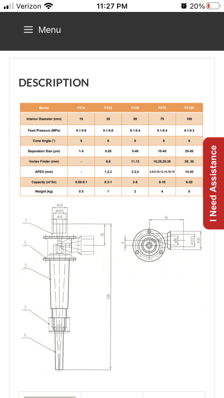

Has anyone ever seen or know of a vendor that supplies tangential inlet pvc saddles or tangential outlet reducing tees? I'm looking for either a 2" tangential saddle on a 4" pipe or a tangential outlet reducing tee with a 4" run and 2" branch. Any help appreciated

Have you looked into lab scale units? Spray dryer companies have some small units. Maybe you could get one second hand.
Good Luck,
Latexman
Latexman, that is a great idea. The cyclone image you show would be great actually since it says interchangeable apex and feed which is what I will need to experiment with.
Do you have a source of where that image came from?
JL
Update
I found a company in south africa, trithane, that sells individual cyclone parts - apex, inlet housing, vortex finders etc. This is my easy out.

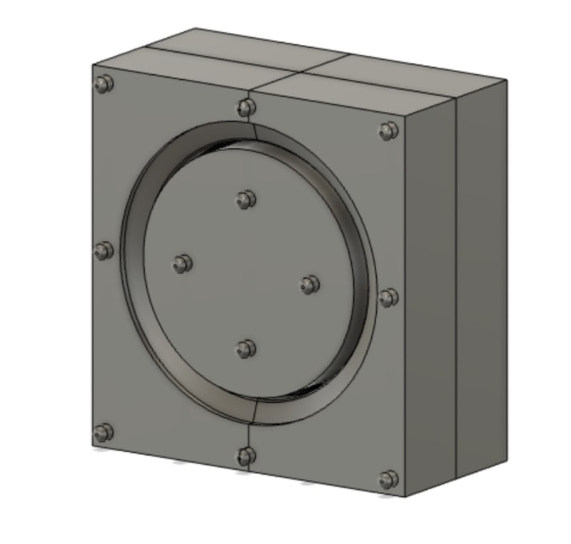

Based on the quotes I've received for fabricated units. I will make it myself...trying my hand at casting. I modeled a sanitary clamp version and created a mold for it. Hoping I can print it, clamp it, and pour it using a rigid urethane resin. Anyone know of a good rigid urethane resin? Flex-it 80? I do not imagine the pressure will exceed 10psig inside the part.
