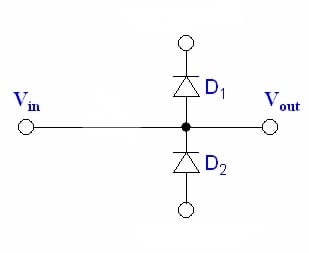

If the noise is large enough to cause issues with other filters, it will still show up. The output voltage is simply the input voltage minus the diode drops.
TTFN (ta ta for now)
That measurement appears to be clamped by the diode forward drop voltage; it's not measuring the output voltage.
Rectified noise is still noisy.
In Spar's application, the noise amplitude at high frequencies may easily by greater than the signal amplitude at low frequencies.
Bill
Ohm's law
Not just a good idea;
It's the LAW!
My reasoning was that positive noise goes forwards, and negative noise backwards, similar to this method.
(It's easy for me to think outside the box since I'm not even in it) :-)
That's different, you're showing a clipping circuit, designed to reduce the amplitude of anything on Vin to not exceed the power rails by a diode drop, so any noise that's greater than Vdd or less than GND gets clipped to Vdd+Vdiode or GND-Vdiode, and the noise is otherwise intact. This is the standard approach for ESD protection on ICs

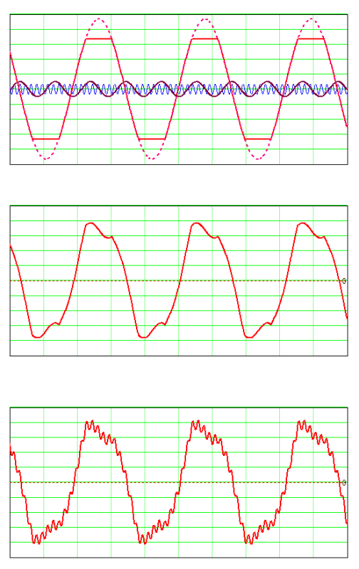

Since my original start of the thread, I've done much more investigation of the signal noise. You were very helpful because you highlighted all of the techniques I had already tried, and motivated me to dig further into why they didn't work. I really didn't do a good job characterizing the problem in my earlier posts, and having looked at it more closely, I can describe it much better now.
My turbine's base AC signal varies from 5Hz to 20 Hz. It's a 4-pole machine whose operating speed ranges from 150RPM to 600RPM.
The first distortion is that the wave isn't really sinusoidal to begin with. The next distortion is the clipping to the battery voltage, which chops the top of the sine wave. The clipping is done by a rectifier switching on and off, which introduces a variable current load on the circuit. Various terms for this, such as "commutation" or "switching" spike but these might not be good expressions for what's going on. Given that the system is 3-phase rectified, there is a 3f harmonic associated with the variable current load.
The process I used to convert the induction motor into a self-excited generator (by fastening magnets to the rotor) introduces a "slot harmonic" which ripples every N slots of the stator. This motor has 36 slots and 4 poles so the ripple is 18f harmonic. Physically this is experienced as "cogging" that you can feel turning the shaft by hand. The amplitude of this ripple is determined by the inertia of the whole system. A bare shaft turned by hand has very little inertia so the 18f harmonic is huge. Once I fasten the driving rotor to the shaft the system inertia keeps the rotational speed more steady, but the 18f doesn't really go away.
The magnets are also the reason the baseline AC wave isn't a sine. The picture below illustrates one condition at one speed (about 200RPM). The waveform changes significantly at different speeds.
I have also been able to model this noisy system. With this in mind, and referring back to the 5Hz to 20Hz operating range of frequencies, selecting a low-pass filter becomes a deep compromise. I was pleased to find a way to program the microcontroller using a method that completely ignores the noise instead. There are now no noise filters on the tachometer's inputs, nor any device like an encoder needed.
