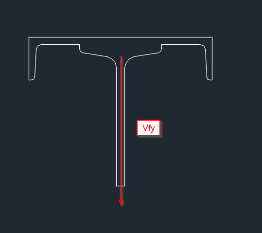

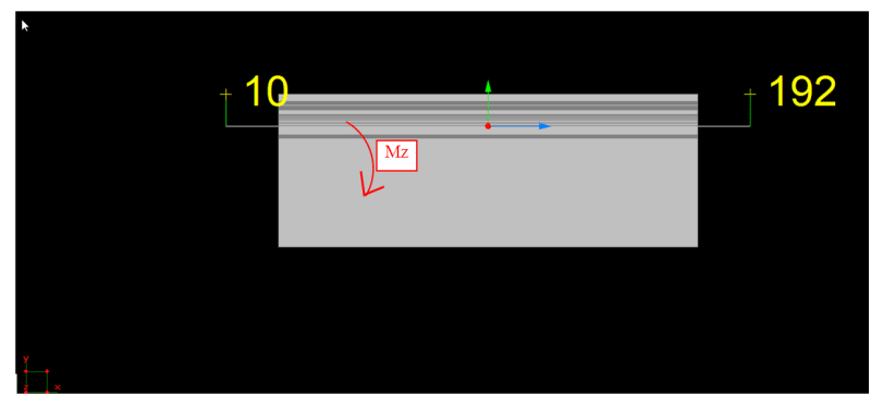

Hi!
I have to evaluate a Beam in a T form receiving Shear + Moment at a moment connection.
The CSA S16-09 does not give a combination criteria in the form of Vf/Vr + Mf/Mr.
It there a combination criteria in a structural standard that would verify this? Or do I have to check this using mechanics of deformable solids theory?

@BAretired:
Thank you for your answer!
Note that this is not a cantilever, but a beam with 1 support at each extremity of the member. Both ends are fixed (moment connection).
Also there is no I beam, it is a custom T-Beam built of a cut S-Beam and a channel, so there is no bottom flange.
@Enable:
Concerning clause 14.6, I do not have stiffened girders.
Thank you for the Eurocode 3 reference! In which part of the Eurocode 3 is the section 6.2.8.2?
NZ stele code also has a shear/moment interaction formula for what it is worth. Similar to Eurocode there is no interaction if V* is less than 60 percent of the shear capacity, nor moment greater than 75% of the moment capacity (refer to interaction diagram plot below):-
Keep in mind for a tee as well that the shear stress distribution is not uniform/symmetrical like the web of a doubly symmetric I section member, so you'd need to apply whatever provisions are in your code for assessment of that. In the worst case there would usually be a further max reduction to the shear capacity of 0.83 which corresponds to a rectangular section where the ratio of max shear to average shear is typically 1.5. This 0.83 can be used conservatively in your situation for a tee.
The leg of the tee if in compression may be slender as well and subject to local buckling/slenderness effects, so you'd need to consider that as well in working out the plastic moment capacity and the effective section.
