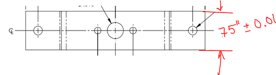

Symmetric to Centerline note is given to below drawing attached, need to understand how manufacturer will punch the holes at what tolerance.
There's no tolerance for the location of the holes relative to the width. "Their best" is the standard that will be applied.
Position tolerances of these holes depend on width tolerances and its straightness due to your material's camber.
