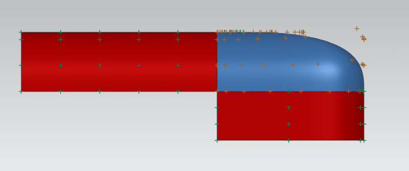

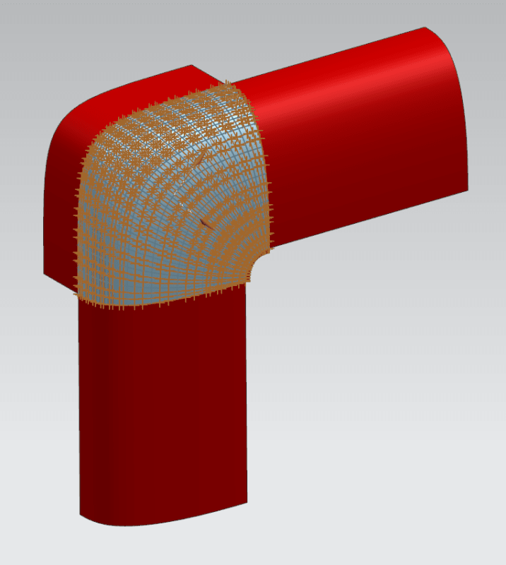

I've been a long-time lurker on these forums, and have learned a LOT from you all over the years. I've come across this problem a number of times and have thoroughly stumped the other designers I work with, so thought I'd query The Brain Trust.

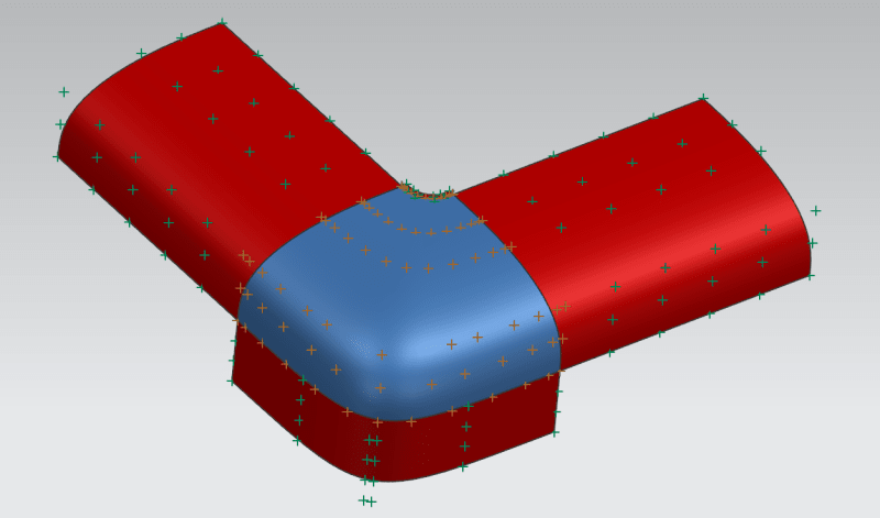

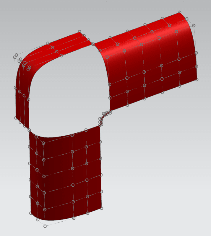

I have a pretty simple corner between three 90-degree planar faces with three G2 Styled Blends (5-degree single-patch) and a G2 Bridge Curve (modeled as a Law Extension so I could export a parasolid). I would like to fill that hole with another G2 surface.

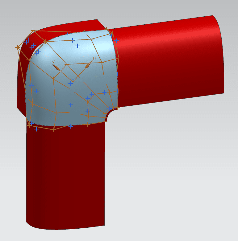

Mesh Surface and Studio Surface both produce high patch-count surfaces that bulge out and cause issues trimming the planar-solid. The Sweep tools don't provide any tangent or curvature continuity. My best effort yet has been to create the single-patch using a G0 Mesh Surface, use Match Edge to control the continuity to "the corner" Blend, and use X-Form to manually move poles into the correct position. Here my personal favorite tip comes into play; sticking a post-it note to my monitor as a straight edge.
Alternately I can extract Point Sets using B-Surface poles, create Lines and Planes, and manually create the surface I want using Surface From Poles. This creates the perfect version of the surface above, but it's non-associative which goes against our modeling best-practice.
So the question is; is there an associative tool which will create this corner, G2, single-patch?

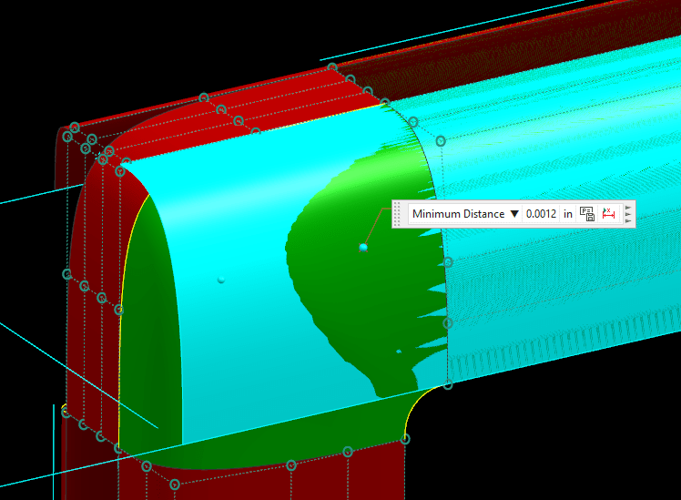

Normally I'm not overly concerned with patch count (within reason), what really drove this issue was that my Studio Surface/Mesh Surface was pulling out from the original curves which is causing a Trim failure.
Where patch count comes in; it is possible to make this a single-patch feature. I'm just having a hard time stomaching that NX doesn't have a feature to create this surface. And I'm hoping I'll learn something along the way.

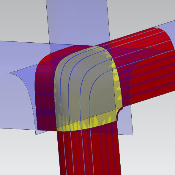

For fun, I tried "fill surface" on your part. I used G2 for the large surfaces and G1 for the small surface (it wouldn't take G2, but since it is a planar surface, I didn't think it would matter much). The reflection lines on the resulting surface looked surprisingly good. I didn't check patches/pole count/etc.

Styled Corner is a really good suggestion, I've used Blend Corner before but haven't tried Styled Corner. I like it a lot and will probably come back to it. Unfortunately it bulges out in the middle and causes a trim failure, same as Mesh Surface and Studio Surface. Fill Surface produces the surface closest to what I'm looking for; doesn't bulge, pretty low patch count.

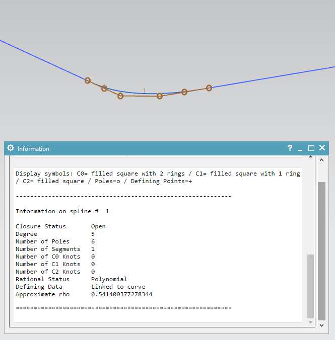

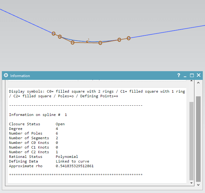

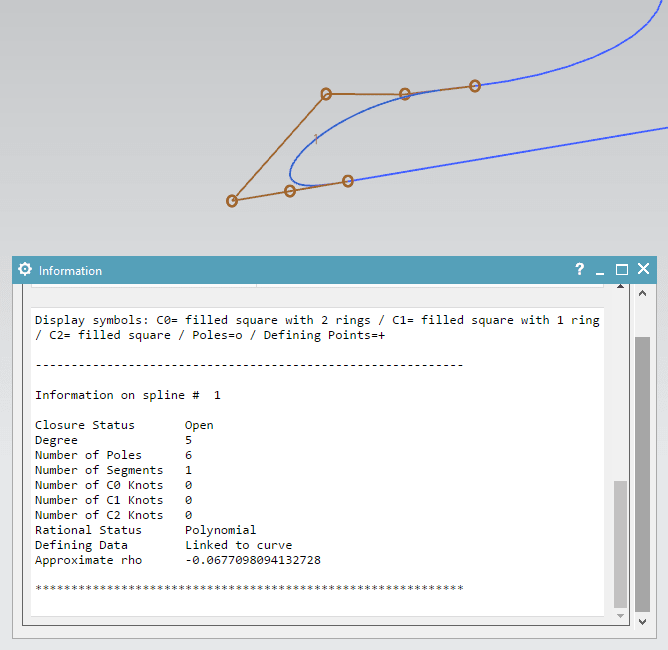

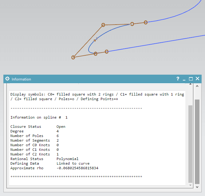

It sounds like everyone is equally stumped regarding the creation of the single-patch surface. Like I mentioned, I've come across this a couple of times. I think NX is programmed to maybe overlook the elegant solution and follow the solution that is reliable in all situations. What I mean; two intersecting curves/lines can be connected with Bridge Curve at G2 with a single-segment, 4-degree, 5-pole spline. Two poles are at the endpoints, two poles control tangency, curvature is controlled at the intersection point of the two lines. But functionally NX will always create either a 2-segment 4-degree spline or a 1-segment 5-degree spline, presumably because that function won't fail for non-intersecting curves/lines.
I feel like NX follows similar functionality with the surface tools as well; it likes to create at least one extra row of poles to de-couple Surface 1 from Surface 2 so that tangent/curvature can be independently controlled on each side and presumably so the tool works in more situations. I understand *why* it does this, I just find it interesting that step 1 is to overlook the simple solution. I feel like instead of being programmed to look for the elegant solution NX just takes a sheet and tries to stretch it around until it meets the boundary conditions within tolerance.

John, that guy (whoever he is) sure made a good pitch for fill-surface. You use it in exactly the same way I do; filling in holes in Industrial Design data. It also is a good way to make the pesky 3-sided surfaces IMO. In this case it does create a surface which fits inside my boundary data but the pole-count is a bit of a mess. Recall, my Sew tolerance is really high.

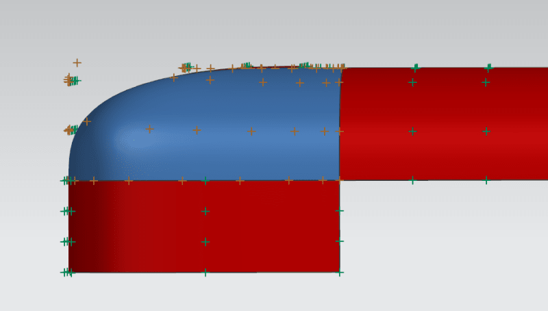

Here is my most frustrating attempt to date. This is Studio Surface (although Mesh Surface looks very similar) with G1 and rebuild as Auto Fit 5x1. *SO* close...
